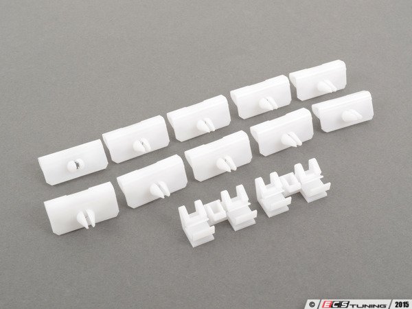

Make sure all the clips are in correctly, sometimes they dont' snap in them all the way in and they did not break the trim itself.
Trim Cover Clip Hardware Kit 07131490537
http://www.ecstuning.com/Search/SiteSearch/07131490537/
and
Trim Cover Chrome - Set 51317051527 KT
http://www.ecstuning.com/Search/SiteSearch/51317051527/

safelite called me back and told me that they forgot to order the corner locking tabs. That is why the chrome trim wasn't secured down properly. I think they're #7 on the diagram.

Thanks for the update, I would get all the clips checked. We have the clip set linked above.
