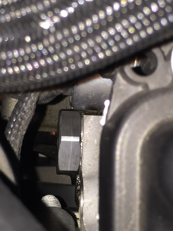

Glad I found this thread. Great information. I just attended a local MINI Service Clinic (very valuable experience) and got about 30 minutes with one of their techs in the back with our 2010 R56 up in the lift. At 14,500 miles, there really wasn't much to report. All looked great...
I was, however, told to keep an eye on some oil "seepage" around the chain tensioner.
Reading all of the posts about the bolt "backing out" I remembered where he pointed, came home, and checked myself with a flashlight. I was able to clean any oil off of the bolt and made it look pretty much brand new....now will look to see if any more accumulates. There's never been anything on the garage floor so any oil which accumulated on the bolt was minor. I took a picture AFTER I cleaned it.
From any out there who have had the "back out" problem, would I notice it actually starting to move out of place? It looks flush here.
Attachment 108938
I"m not a mechanic (well maybe old school backyard) but I doubt you'd see any indication of it backing out. First indication would be oil seep I would assume. Good job on taking the photo by the way. I tried but could not get enough light...
