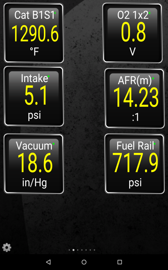

Hello all, I will try to keep this short but also want to give as much info as possible in order to solve this problem. I have a 2007 Cooper S automatic with 84000 miles. I bought the car used almost three years ago and about 6 months after that I noticed that when i drove the car in stop and go traffic it would Idle really bad. When i came to a stop the engine would rev from about 7000 up to 9000 a few times then quiet down till i came to the next stop. It stills does it till this day and its driving me crazy. One very important note is that i have never gotten a CEL the whole time ive had the car. Ive tried a few things that have been suggested by two different well reviewed Mini mechanics. First shop suggested a carbon cleaning with just a chemical solution and told me to add Chevron with Techron every 3000 miles. This did quiet the problem for about 6 months till it came back. Next shop suggested a possible fuel pump problem but said i would have gotten a CEL by now. They kept it over night and ran some test but only ended up catching a slight misfire in cylinder 3. They replaced the coil and said hopefully it fixes the problem. It didn't .
So ive done some searching and have found people with the same problem but the threads are never resolved. I bought a OBDII and Torque app and have been logging some drives. I did notice under The vehicle test results that i had a red/not OK O2 Bank 1 Sensor 1. Is it possible i have a bad O2 senor? Also this problem only happens when the car is warmed up and driven kinda hard. Thanks for any help and sorry this post was so long.
[IMG]http://<a href=http://s1381.photobucket.com/user/Mike_Drew/media/Screenshot_2015-02-25-11-16-41_zpsrhdrkqo1.png.html target=_blank>Name:  Screenshot_2015-02-25-11-16-41_zpsrhdrkqo1.png
Size:  339.4 KB[IMG]https://www.northamericanmotoring.com/forums/<a href=http://s1381.photobucket.com/user/Mike_Drew/media/Screenshot_2015-02-25-11-16-41_zpsrhdrkqo1.png.html target=_blank>Name:  Screenshot_2015-02-25-11-16-41_zpsrhdrkqo1.png
Size:  339.4 KBName:  Screenshot_2015-02-25-11-16-41_zpsrhdrkqo1.png
http://i1381.photobucket.com/albums/...psrhdrkqo1.png

The chemical carbon cleanings don't really work. You need to media blast with walnut shells. Independent shops should do this for under $400.00. If you have never done a real carbon cleaning then you are way overdue. It's worth taking a look at the valves.
Have you pulled your O2 sensor and looked at it? I'm not an advocate of just replacing parts but the O2 sensor is not really that expensive. If you think it is your HPFP, I believe that some apps can log fuel rail pressures. MINI did increase the warranty on them for some model years.
Also have you looked at your spark plugs?

Both shops have told me they don't want to do a walnut blasting till a CEL comes on. I actually insisted on the chemical cleaning back then for peace of mind and when i picked the car up the shop told me there wasn't that much build up. I don't know if i have a rare r56 s but mine doesn't go through any oil. I went 8000 miles in between my last oil change and never had to top off the oil. I was even so paranoid that i was checking it wrong that i dropped $80 bucks on the Craven aftermarket dipstick.
I'm not mechanically inclined to pull the sensor unless i was shown exactly where to find it and then how to see if its bad. Is it easy?
The last shop said they didn't think it was the fuel pump either because it didn't show any symptoms when it was cold.

Do you have a mini dealer close by? The mini lots a lot of computer codes that not all shops are equipped to read. Have you had the timing chain recall done? That could be a good reason to go to the dealer and have them work on the car and have them look at the idle issue while they're at it. They have diagnostic tools for seeing if the HPFP is failing (it's a common failure).
Unfortunately it doesn't seem like you have a bad enough issue that we can really track down the root cause. Certainly not over the internet based on some descriptions and a few phone screenshots. It could be any number of things so it's hard to do anything but suggest replacing parts until we happen to stumble upon the solution.
