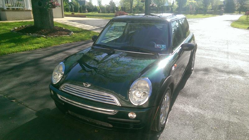

Hey guys, so i wanted to share my experience with my 2004 r50. When i bought the car it had 68xxx miles, now it has 98xxx. To my knowledge the car was involved in a very minor accident in the front (cracked front bumper). Has a clean title. To get full story on how i obtained the r50 check out "My story. New comer from Philadephia" on NAM.
