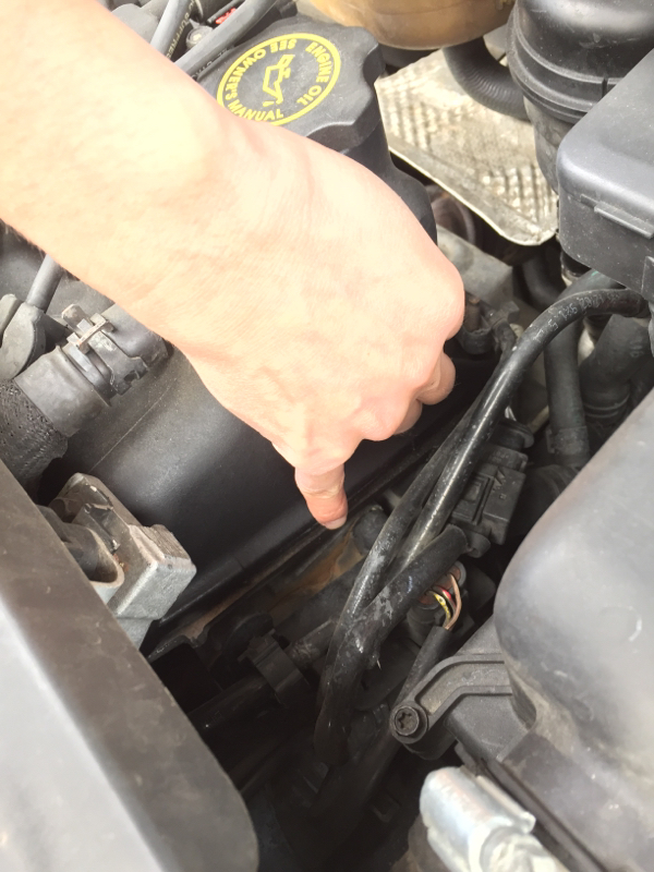

So I have been trying to chance down this water/coolant leak.
It's on the left side of my engine head. I can see the water bubbling out and it's pooling. Near the intake arm to the air box
I can't upload the picture I took at the moment because of this crappy IB app interface.
I think it's not the head gasket because water/oil are not mixing.
Im not leaking oil thank god either.
Finally got it attached

Is really easy to change the gasket
Only 3 10mm screws to remove it.
But Check Well because maybe the cover
Can be cracked....
Also I recommend to put new thermostat.
I Installed N' My Mini The M7 Thermostat
The M7 is 180F & The Original is 195F

Definitely your thermostat housing. Recommend replace thermostat with new gasket.
