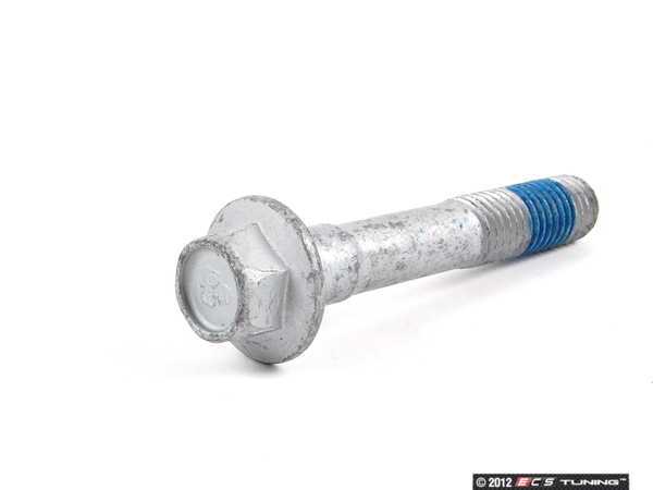

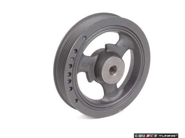

11237829906 Harmonic Balancer
http://www.ecstuning.com/Search/SiteSearch/11237829906/
And the hex bolt: 11237829918
http://www.ecstuning.com/Search/SiteSearch/11237829918/
So now you have the part prices to figure in.
