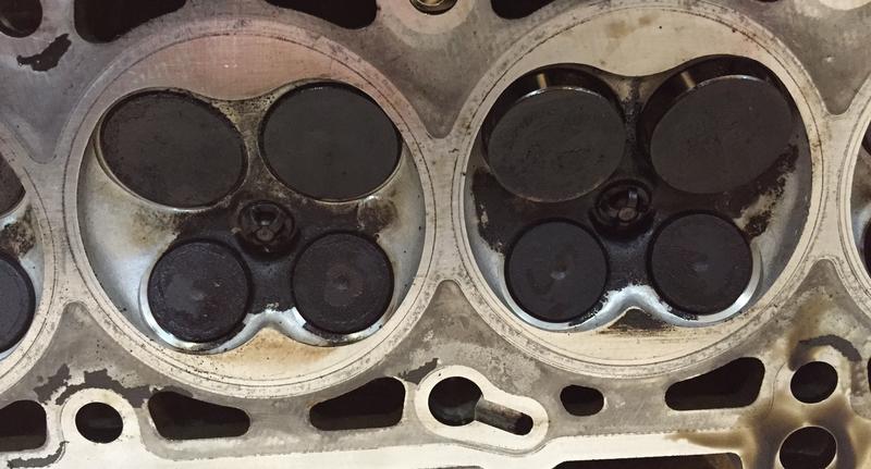

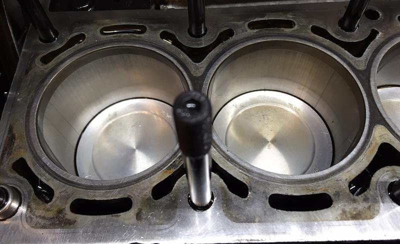

Update- pulled the head today. Thinks looks good overall, but the exhaust valves look real oily and gooked up with carbon. The tops of the pistons still look great (I cleaned them when I rebuilt the engine, but those are the original pistons). Be happy to hear what people think of the exhaust valves.
Cylinder walls are well polished, perhaps my choice not to hone and re-ring when I had the engine out is biting me.
I'm going to re-ring it now assuming I can get the pistons out once I remove the oil pan without dropping the engine. Will hone it with a ball hone, too. I'm a little worried about doing this on the car, but I intend to be diligent about cleaning up any mess.
I bought a "delivery miles only" head from the UK since it is cheaper than buying a set of valves (Isn't that weird....). So, that also gets me tight valve guides and seals.

Just wanted to post a follow up. I decided I wanted to lick this problem once and for all, so pulled the head off, replaced the valve seals (with OEM instead of Fel-Pro, FWIW). I also dropped the oil pan, pulled the pistons and replaced the rings. Gap was crazy big (should be around 0.3mm, I was seeing 1-1.2mm), but rings were physically OK. I honed the block in place using a ball hone. It still measured in spec (before and after honing).
