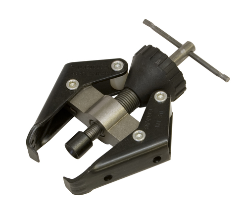

Lisle puller
After soak with solvent...this is the best tool for tapered shaft/spline.
