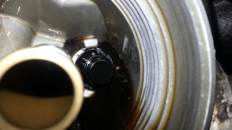

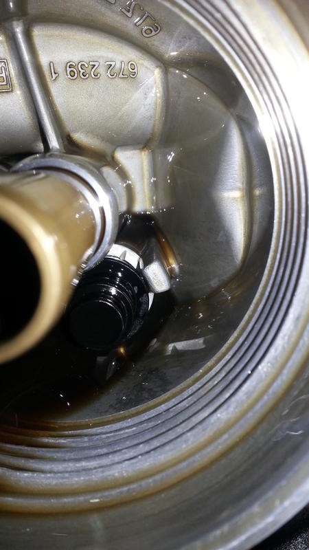

OK, another update.
Installed timing chain tensioner, no change.
So today I pulled the filter cover off again, took some pics (drainback valve looks OK to me), and seated the filter first, then the cap. My thinking is that maybe the twisting of the filter is cocking the drainback valve just enough that its not sealed all the way.
Pics attached, not the greatest, its about 35 degrees and snowing, and my hands were getting numb, and I didn't have a good rag to clean out the oil.
I called Mini and talked to a tech, and they thought if its not the drainback valve, it could be a seal for the oil pressure sender, that is integral to the housing. I don't see how that's possible, but then again I don't know. The only seal I can see is the one that goes to the block, and I cant see how that can be leaking unless its leaking from one chamber to another.
I tried to find an oil flow diagram, but came up empty.
I think the next step is to drill a hole in the side of the oil filter cap, tap it, plug it, and let the car sit for a day or two, then take the plug out and see if oil comes out, if not, then obviously the filter housing is empty and I guess i'll order the whole housing.
Running Castrol 0-40. I cant imagine a difference in 5 weight cold would cause this to happen.
