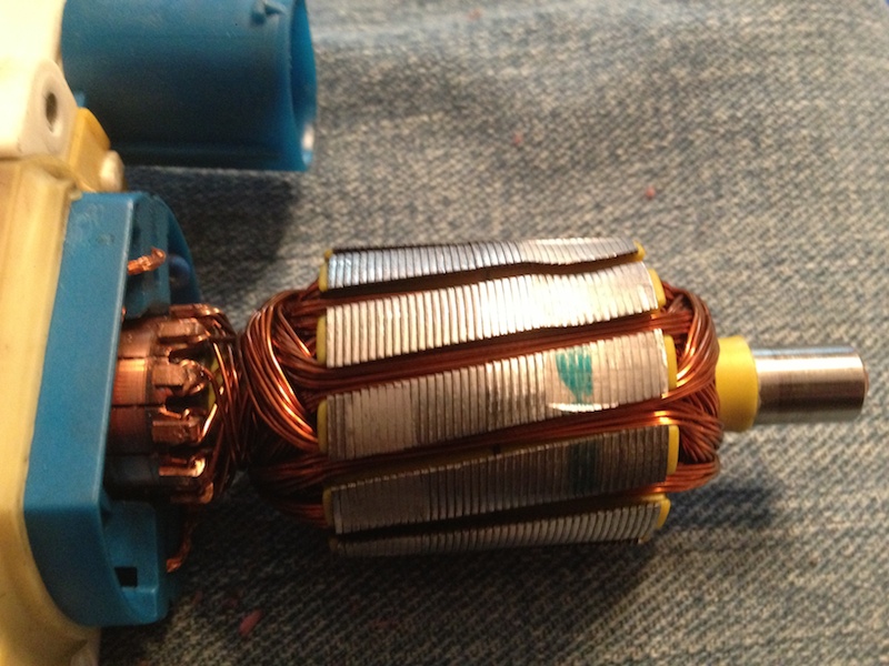

Having just taken my motor apart, I am skeptical of the theory that it is caused by a "dirty motor". I had seen that post on MINI2 and thought that cleaning the commutator would be a solution until I took mine apart. When I got my motor opened, the commutator was a tiny bit dirty but not significantly. The brushes were barely worn. But the armature teeth were very worn, and I think this is a reason why the window stops working. I think banging on the door lets it get over the steps between worn areas and unworn, until the steps get so deep you can't get bang the door hard enough to jump over them.
I have more to my analysis but I'll save it for another time.

Very interesting. Having never taken mine apart, I just accepted what that other thread covered. Always great to have a second opinion. Do you have any pics of the worn teeth?
I do! Check out my post 3-4 posts up... there's a photo there that shows the worn armature teeth.
Ah, didn't realize it. The silver parts, some of which are colored green?

Yes, exactly. Just below the green bit, you'll see a ridge or step in the armature tooth. There were several such features on mine.

Gotcha. That certainly makes sense.
Has anyone tried any aftermarket replacements since the OEM seems to be flawed? I ordered some ACI motors for mine - will finally be replacing them soon.
Will be interesting to see how the wear in my old motors compares to that picture.

My take on the reason for the wear is that the bearing at the end of the shaft is too loose in its seat. When the motor's worm gear engages the other gear, the seat play allows the motor to move off axis & wobble, leading to rubbing between the armature teeth and the magnets. If I am correct, for another brand to perform better the OEM they would have to have a tighter fit between the shaft bearing and seat.
