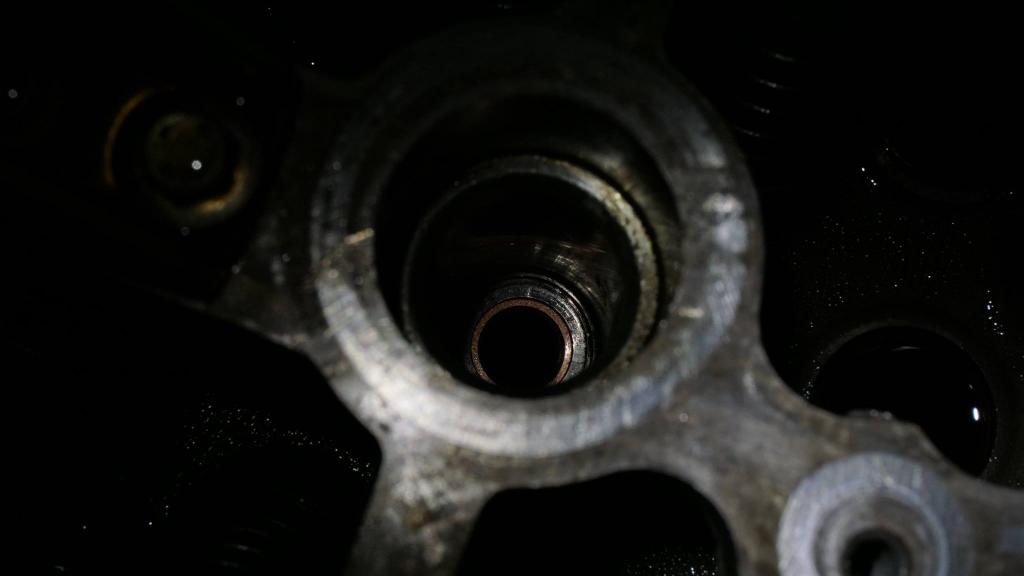

Time-Sert is by far the superior product to place in your head as thread replacements go. Helicoils tend to vibrate and eventually come off and at times, can come off at the same time when removing plugs.
We recently performed this on a R56 as shown below in the photo. Let us know if you need any assistance.
