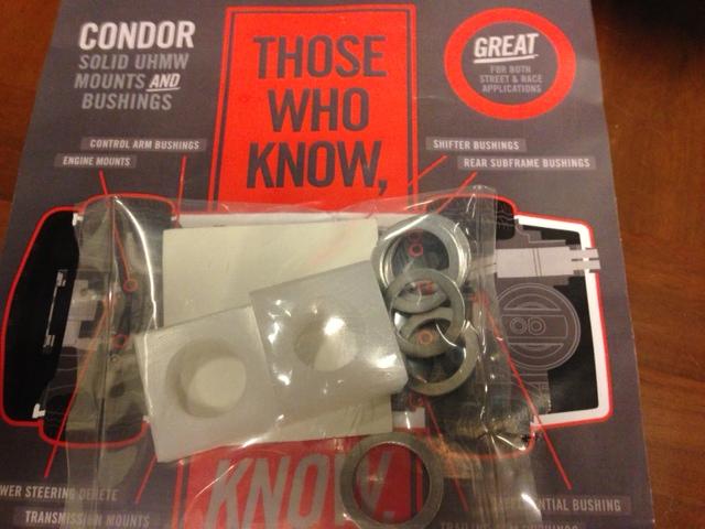

If you opt to get the $50 Condor PS Pump Delete Kit, here's the procedure(post#106):
https://www.northamericanmotoring.co...le-soon-5.html
Here's the simple kit:
Old Aug 24, 2014 | 08:36 PM
MiniManTim's Avatar
MiniManTim
Joined: Aug 2014
Posts: 76
Where are the banjo bolts exactly? I see that install process looks easy but someone said it took 2.5 hours. Where are they underneath?
Old Aug 24, 2014 | 09:02 PM
minsanity's Avatar
minsanity
Joined: Aug 2009
Posts: 1,505
Likes: 25
The banjo bolts connect the hoses to the rack.
