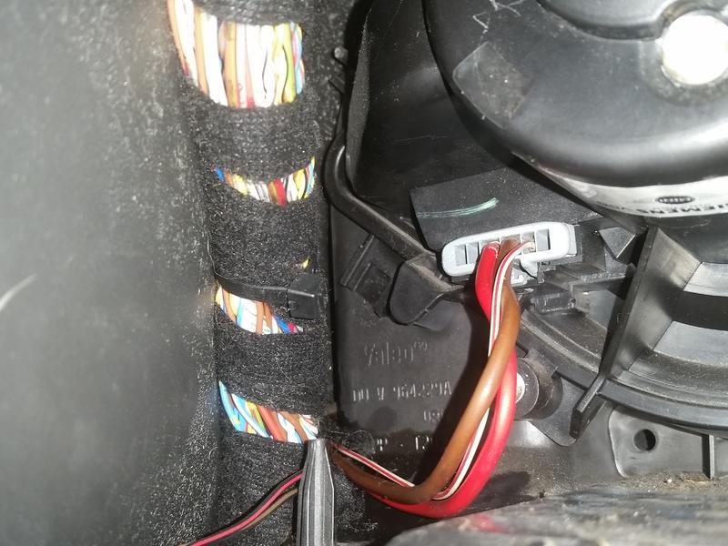

Can someone tell me how to jumper this air condition fan? The controls all light up and baffles work but the fan does not blow any air. Is there a trick to getting it out without removing the dash?

The blower does not blow at all. Not a restriction problem. I really need to know how to jumper and test it. Also want to know the easiest way to get it out of there to replace. Tell me I don't have to remive the whole dash!

Check the fan resistor that control the fan speed, maybe shorted due to corrosion and aged. Its in there behind the globe compartment.

Even for a automatic temp control? I thought they were different? Can someone send a pic of this jewel?
