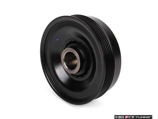

+1 The crank dampener looks like this new. See what shape you are in.

Update; all the pulleys, including the crank, looked beautiful as did the belt. I can tell they have been replaced recently (I think in 2012 when the car popped back up on carfax) so it is not the Crank damper. When the starter was turning the engine all the pulleys moved as they should.
