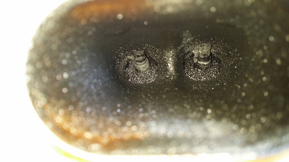

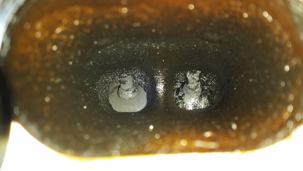

I'm in the process of cleaning out the carbon buildup on my 2008 MCS with 58k miles(New to me.) I was really shocked to see how much buildup there actually was!
Thanks to the forum, manifold removal was a piece of cake.

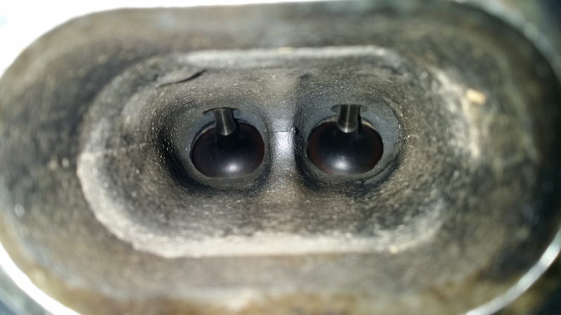

I did finish it on Sunday. Taking the manifold out/reinstalling it was the easiest part of the job. Getting all the carbon build up out was a major pain! I'm not sure if my compressor wasn't strong enough(could only spray for about 40 seconds before it would kick on), or if I should have gone with the coarse walnut shells, but it took HOURS of spraying/scrapping to get it all out.
Driving it this week I've noticed about 5mpg better overall gas mileage(Right at 40mpg now with about 85% highway driving.)
One thing I find weird is my boost pressure seems to be a bit less than before the job, but the car pulls harder? I was seeing 16psi before, and now I'm getting around 14psi.
Here is a pic I took when I was almost done. I found that using the phone/flash was much better for judging my progress than a mirror.
