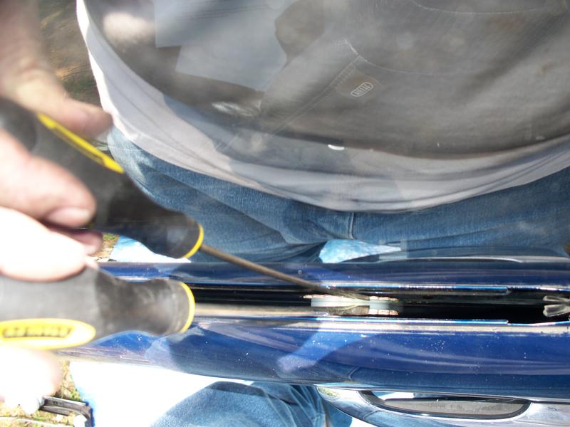

I have done several of the Mini window regulators and posted a page with pictures and instructions for replacing it. If you replace the window regulator don't buy the cheap ones. I replaced the same window regulator three times because of cheap parts.... spend a little more money and get a good one.
I hope these instructions help http://www.minneapolis-moline.com/miniwindow.html

Originally Posted by minibx
Since you window is up and if you decide to do the job you'll have to take out the regulator too, you have to try and lower that window about half way otherwise you'll have to cut the regulator cables and that means that you'll have to buy a new one, if you can not lower the window it will be a pain to loosen the pegs that hold the window to the frame and regulator, you will need a special tool Outmotoring has it for less than 30.00. You'll need to take the chrome trim off to reach the pegs, that's if the window is all the way up
Sometimes you can remove the outside window trim with the window up and use a flat blade screwdriver to remove the "cog like" retainers for the window. Place the flat part of the blade on the cog and bump it with your hand a few times counter clockwise. I was able to loosen mine with the window up using this technique. I then just used the screwdriver to spin the retainer out so I could remove the window.
Good luck,
Tony T
