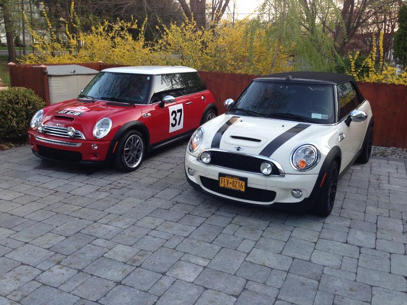

So I just got my MC40 R53 with only 24k on the clock shipped up from FL and I have a major oil leak. The dealer did an oil change and from what I can see the oil leak is coming from around the oil filter housing. Much worse when car is running. Anyone have any ideas? Its not coming from the oil pan at all.

BTW the MC40 looks awesome. What a time warp.
