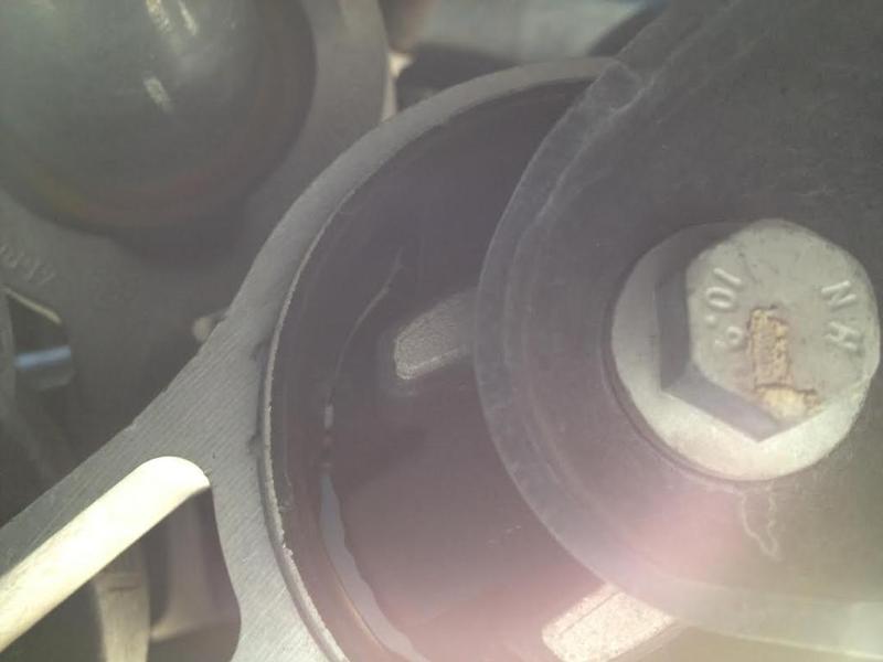

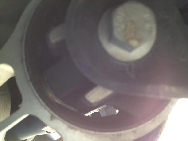

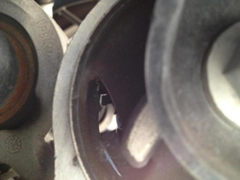

Hello there is have been trying to identify an issue I'm having with my 08 MCS with about 45k. Been having excess road noise through steering wheel and overall ride. Checked most everything I can think of. There is no slop in steering and when I got the car off the ground I noticed my torque arm bushing looked a little odd. Is the bushing supposed to have a snug fit to housing on the arm? I will attach some pics to see if I can help illustrate my question. Any help on this would be great or a pic of a norm bushing that I could compare mine too

there are no suspension mods as of yet but i took some shots of the bushing and it looks kinda worn out but then again i have nothing to compare it too. :-(

I believe that bushing looks normal, I remember it not being solid so those gaps you see could be correct. did it look torn at all?

P.S.: There is nothing obviously wrong with your engine mount/stabilizer bushing. At 45K miles, you should not expect significant suspension wear yet, unless you hit some major pot holes lately, it which case anything is possible.
