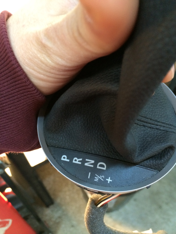

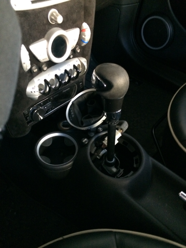

Hello there, my car is an auto 07 MCS.
Recently i am having some issues.
The lights on the shift boot go off, and when i pull the gear stick to the left, nothing happens.
This is caused by a blown fuse.
The auto wipers fuse with 5A.
We change it, it goes away for a while and it goes off again.
What might be the problem?
Thanks.

I have read here that there are electrical bits underneath the cup-holders that can be shorted by water dripping onto them. Perhaps this is related?

Here's an update:
The issue went away for a good 3 months and came back this weekend.
What I did to the car (other than usual, was to get the coilovers to a higher setting.)
Electrically nothing new happened.
The issue repeated itself on 3 occasions ( I changed the fuse 3 times)
- Going over a bump
- Cruising on the road ( Auto Lights on Auto Rain Wipers on )
- Going over a bump
Do you guys know where is the TPMS sensor located in 07 MCS? I narrowed down the problem to that sensor, because I tried switching everything else.
It might be a bad cable maybe. I will get the car lowered tomorrow. See what happens.

Problem solved.
Apparently a cable going near the transmission has been damaged due to high heat and low suspension, that's why the fuse was getting blown everytime I went over a speedbump or a hole. We changed the cable, changed the fuse and no problem ever since.
