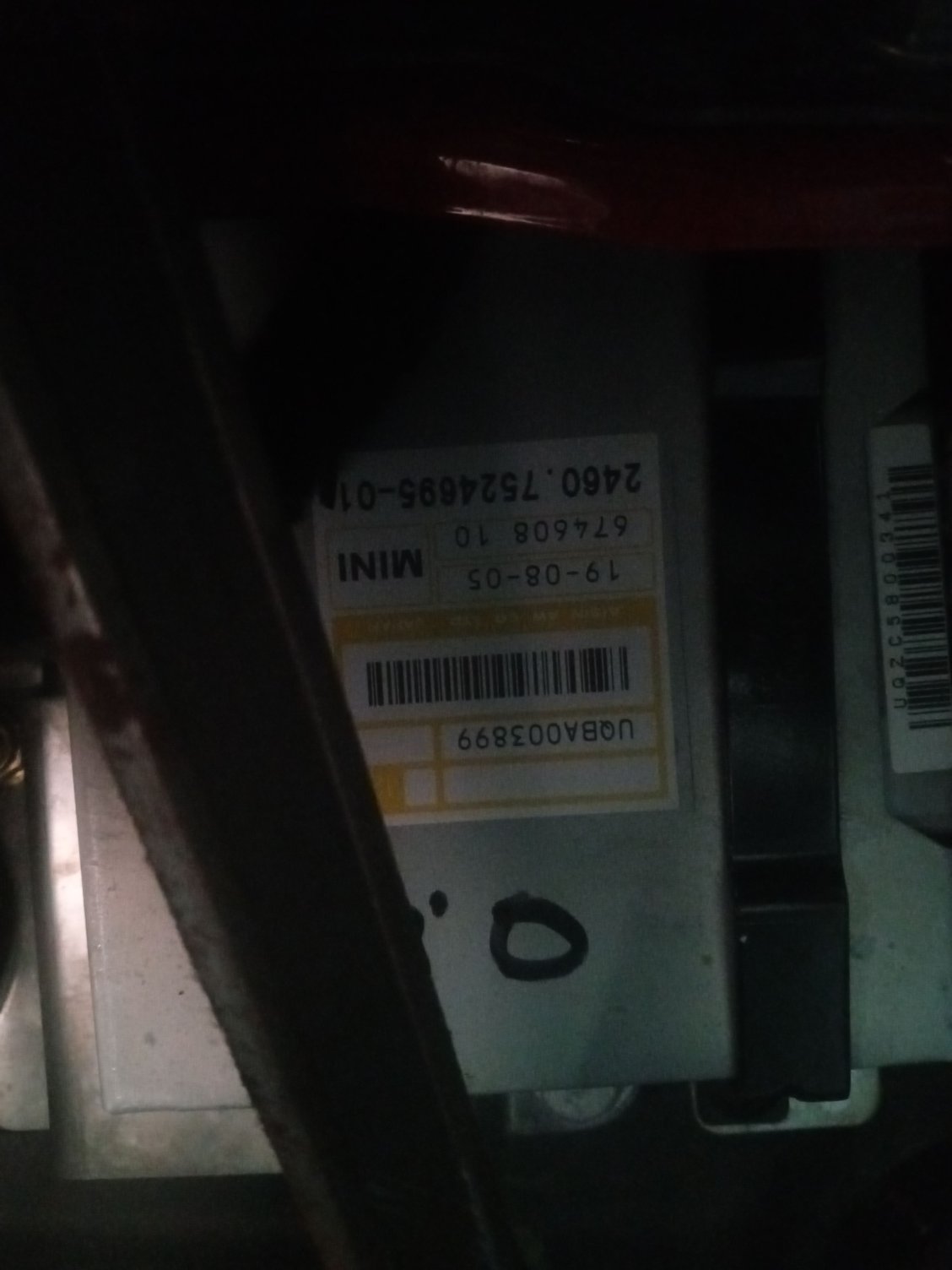

Hey Forteexe,
Did you ever get this resolved? I have the same setup as you do, 06 MCS with the revmax valve body replaced.
I'm having the same codes as you are on a generic scanner. But when I use my more advanced scanner it pops up a more in depth description on the 0700 code instead of just "transmission fault".
0700 Aisin TCU obd relevant fault.
I'm thinking the TCU/TCM (transmission control unit/module) is bad, and that controls the solenoids to shift.
Another thing that's happening with my car is the shift indicator on the plate next to the shift know only lights up N and D, all other positions don't like up. And SD doesn't work when I move the shifter over. However the shifter paddles do allow me to shift gears.

Hey try replacing your Transmission computer module
Originally Posted by Forteexe10
Alright so back a little while and it was found to be a faulty solenoid. Replaced the solenoid bought an entire new set of trans fluid and put it all back together, getting pretty good as this is my third time, less than two hours! Okay well my problem arises again, drove WONDERFULLY after getting it all together. Went out the following day while the weather was about 30 degrees and had a rough time getting into to reverse. Got into drive and voila! Back into fifth gear stuck and throwing codes po700 and po970 again!
Try replacing transmission computer module
