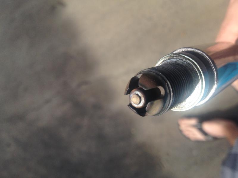

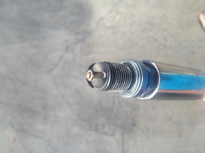

SES light turned off again a few days ago. I pulled the plugs and did a compression test. the plugs have about 10k on them they don't look bad to me. looking through the plug hole the pistons look very dirty. They almost look rusted but there is no water in the oil or any other signs of a blown gasket. The compression test looked good to me. 130, 120, 125, and 125. the numbers seem low but within 10 psi so I don't think there is a problem. I'm going to run a bottle of lucas octane booster and see if that gets rid of the noise. Does anyone know of a good source to buy a JCW head? If I can get a good price I might change out the head while I have the supercharger off.

couldn't figure out how to put all 4 pics in 1 post
