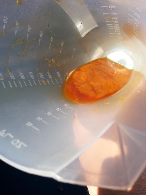

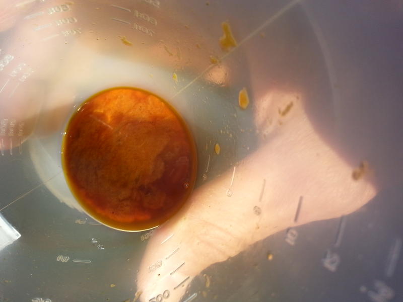

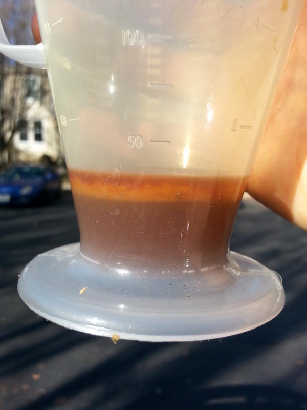

Just wanted to post some photos of the approximately 1 fl oz of fluid that I sucked out of my catch can yesterday. Definitely had a strong petroleum-based smell.
I've had the OCC installed for almost 2 years and I check it once in a while via the dipstick on the can. Sometimes after a drive, I'd remove the dipstick, some sort of vapor gets released and other than the discoloration on the stick and petroleum stinkiness, there never seemed to be much in the can.
This is honestly the only time that I've made an attempt to suck anything out with the syringe that was included in the kit because the dipstick seemed to have very little residue on it other than the discoloration.
Enjoy.

That's a sludgachino - but don't drink it.

Looks normal to me. That is why you have a catch can, so you don't burn that stuff & get it baked on the valves.

In the winter time, I get a bunch of fluid out of the OCC, and have to drain it weekly. I filled a 60 oz jug this fall (since October), and it is 90% water, along with a dark oil layer on top. The oil layer is low viscosity, thinner than the 5w30 that I use in the crankcase.

the white/orange/yellow build up is normal, it's from condensation mixing with oil causing a milky solution, it's a good idea to make sure that doesn't circulate through the engine. this build up can be greatly reduced by making sure your car gets up to FULL operating temp during driving so the condensation burns off in the lines/valve cover, short trips cause it to be bad and can clog pcv passages and valves if its left unattended for years. and by full operating temp I mean the heater vents blowing scalding hot air.
