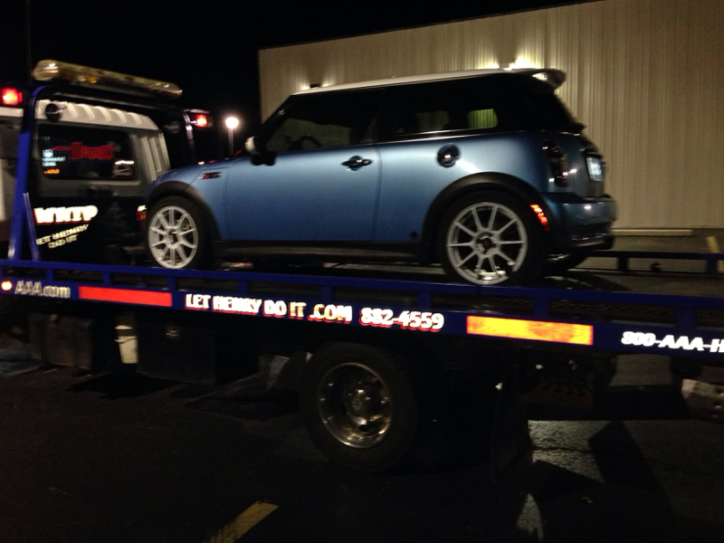

P.s.
Pics from the sad tow. :( last time she was towed was when I first bought her. I had her towed to the dealership for a new immobilizer. Funny thing is that it was exactly a year ago from today!!!
