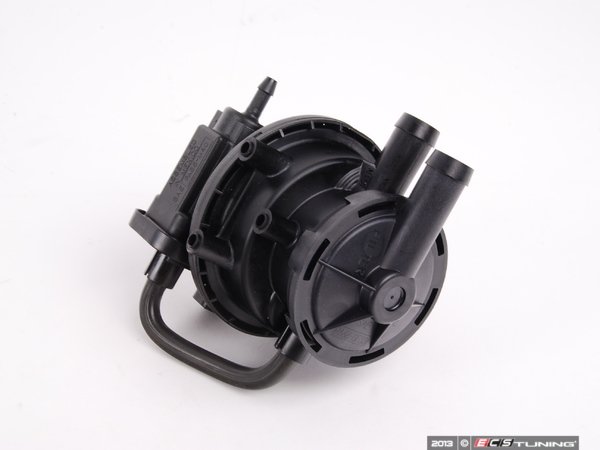

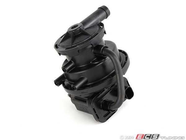

I think you are talking about the leak diagnose pump located by the fuel tank.
There is a version for pre 7/2004 production
#3 in the diagram Leak Diagnosis Pump Part# 16136801158
http://www.ecstuning.com/Search/SiteSearch/16136801158/
and post 7/2004 production
#2 Leak Diagnosis Pump Part # 16117158983
http://www.ecstuning.com/Search/SiteSearch/16117158983/
Here is a link , others have found leaks in the line up in front of the engine , its model specific to the breather line up near the engine bay on top of the engine. I don't know your model or year as you did not state it. But I know you are a Gen 1 MINI.
https://www.northamericanmotoring.co...stic-pump.html
Thanks and hope that helps.
