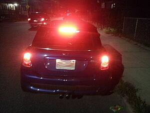

I had to have my alternator replaced about a week and a half ago, got a red battery warning (something like, alternator malfunction, battery is not being charged) and then the AC and radio turned on and off.

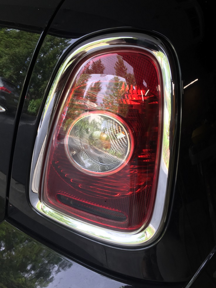

Hi guys, sorry to bring this old thread back up but I didn't see a resolution. I'm having the same issue and I don't think it's caused by anything else other than the tail light itself. I don't think it's a faulty alternator and my day time running lights are off. It happened to my 2011 R56 Cooper S, my current 2013 R56 JCW and my friend's 2013 R56 Cooper S. Did the lower wattage bulbs help? How about LEDs?
Attached Thumbnails The case of the melting tail lights...-1-tail-light-panel.jpg   The case of the melting tail lights...-2-socket.jpg

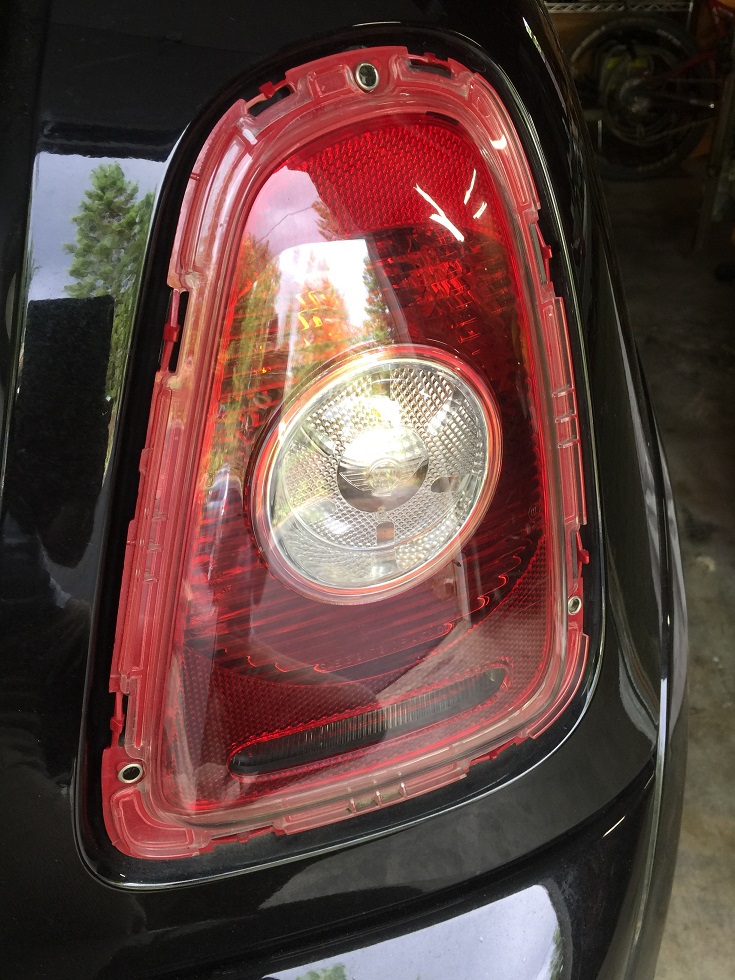

Summary - you dont need to buy anything, unless you're looking for an excuse to buy aftermarket lenses. a few tools and you'll be over this silly issue.
tools
T20 torques driver
plastic trim tool
Xacto knife
ohm meter (optional)
patience to avoid snapping trim ring
Here are visual instructions. skill level is about a 2 on 10 scale. Image 9 is key. you'll see the plastic that melted and prevented contact. scrape that and you're good to go. root cause, probably poor contact. i didnt add conductive grease but you could and it would probably eliminate the issue.
Cheers
Attached Thumbnails The case of the melting tail lights...-1.jpg   The case of the melting tail lights...-2.jpg   The case of the melting tail lights...-3.jpg   The case of the melting tail lights...-5.jpg   The case of the melting tail lights...-7.jpg
The case of the melting tail lights...-8.jpg   The case of the melting tail lights...-9.jpg   The case of the melting tail lights...-10.jpg   The case of the melting tail lights...-11.jpg   The case of the melting tail lights...-12.jpg
