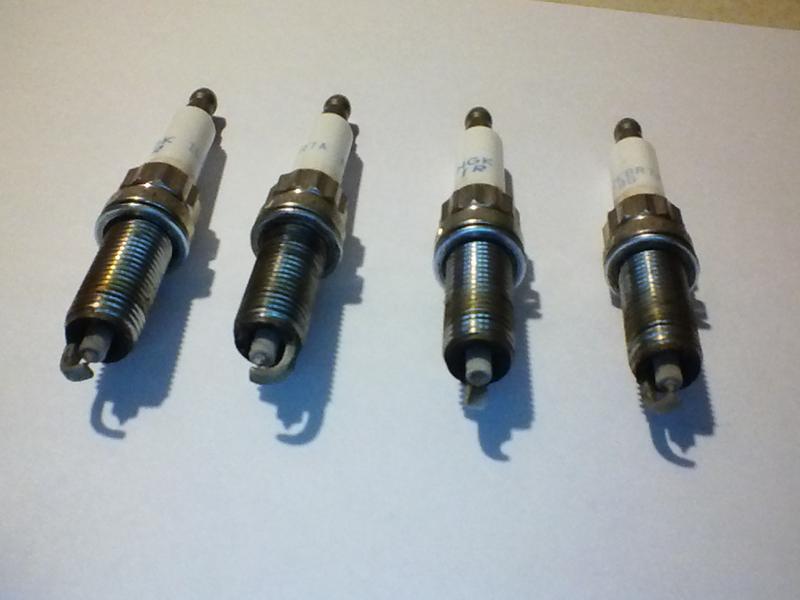

I compression tested the cylinders in my engine this evening. I purchased "Sunny" new and have changed the oil every five to six thousand miles. I currently have app. 89k miles on the car. The results are below:
1 cyl. 2 cyl. 3 cyl. 4cyl.
162 lbs. 160 lbs. 158 lbs. 160 lbs.
I am very happy with the numbers and this was tested dry. I intended to also do the test wet, but decided that it wouldn't really prove anything with these numbers.
I replaced the spark plugs and they look very good. They only had about 22k miles on them.
The reason I did this is that I am getting some engine stumbling when pulling out from a start every once in a while. I have gotten the P2065 code a few times recently on the Torque app. The Bentley manual says "P2065: Fuel level Sensor "B" Circuit". Could this be the HPFP?
I walnut blasted the intake about 20K miles ago, so hopefully that's not the problem.
Thanks to "Oldbrokenwind" and everyone else who contributed to this thread. You really helped make this job very easy!
