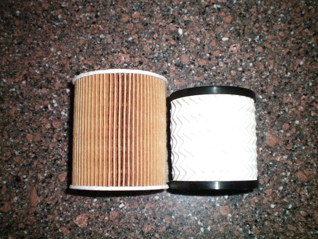

I don't know what engine code they are asking for but do remember that for a 2007 the hardtop went to the GEN2 engine while the ragtop still has the GEN1 engine for a couple more years. The GEN1 and the GEN2 use different filters but all GEN1 filters are the same and all GEN2 filters are the same.
GEN1 left, GEN2 right (both are OE)
note that a GEN2 OE filter kit includes the o-ring for the canister AND the crush seal for the bung.... and you WANT to replace both.
