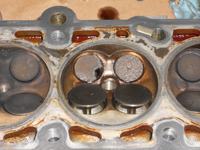

If it was a valve like this it would have sounded like a suburu. If it sounds like an STI and it's not a suburu you got problems. The bottom end on these motors is rare to fail. It is usually the top end that goes. Squirt oil in the cylinder then do compression check if it comes up it's most likely the lower end (rings) if it does not then the top(valve).

So, it turned out to be a broken intake valve spring on the #4 cylinder. I pulled the head and had the valves checked. I am replacing all the springs along with the stem seals and have the head planed. I have already put in the new water pump while it was apart, the flange was leaking at the motor. I am wondering what people recommend to use for getting the MLS gasket cleaned off the block. The Bentley says to not use a metal scraper as it may gouge the block and not seal correctly.
