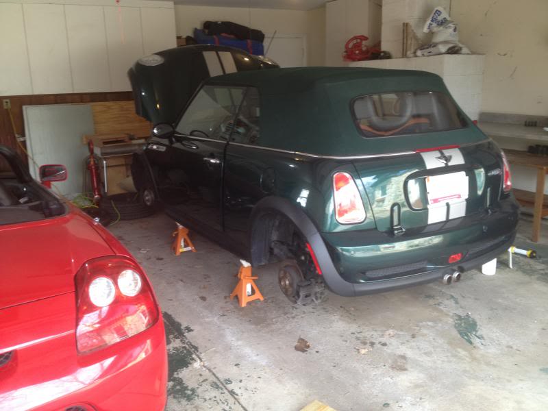

Old Apr 6, 2013 | 04:03 PM
Sidewalksam's Avatar
Sidewalksam
Joined: Jul 2010
Posts: 231
From: right here
bleed the brakes today (finally not freezing ) all went well and still no more returning trifecta.
Will also add I picked up a honda dog-nut spare on crags list for 20 bucks. test fit the spare front and rear and it clears easily on both. It's a 15 but better than not having a spare on a long trip with the run flats a thing of the past.
