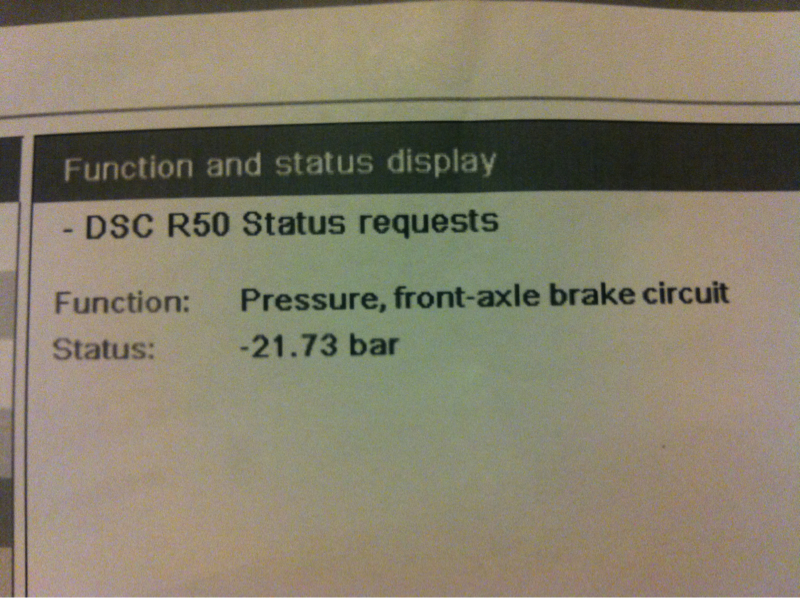

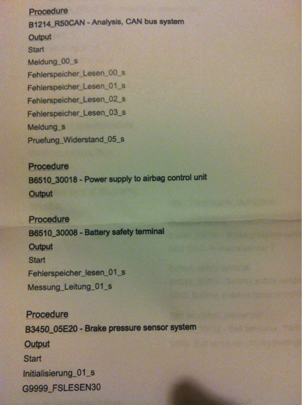

I had the codes run the other day and they came back as follows (I've got a stack of papers he gave me so I'll attach an image of the page he said had the "info you'd need."
For the power supply to airbag I did have a lot of corrosion in that super fuse section terminal in the battery compartment. I cleaned that up perfectly and I haven't had a chance to have him reset and retest since then. If that even matters.
Seems my main returning faults are ABS pressure circuit and airbag safety terminal (Which I've since cleaned, but hasn't been reset yet)

THANKS!!! I also have all the paperwork he gave me if that helps for troubleshooting.
