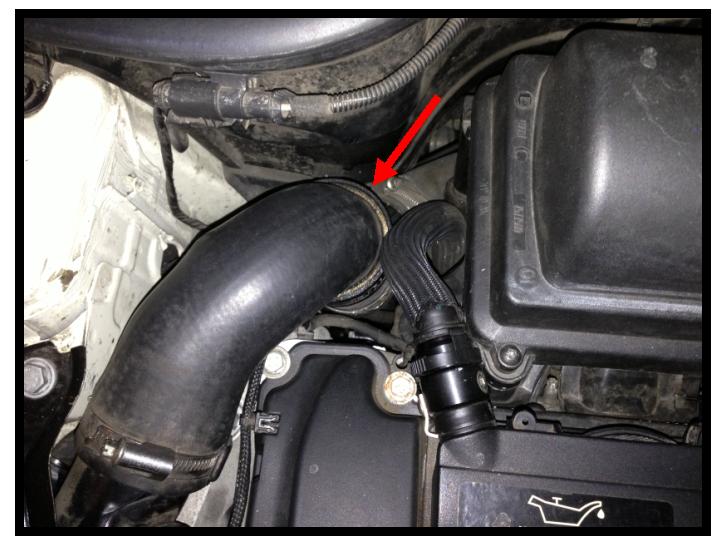

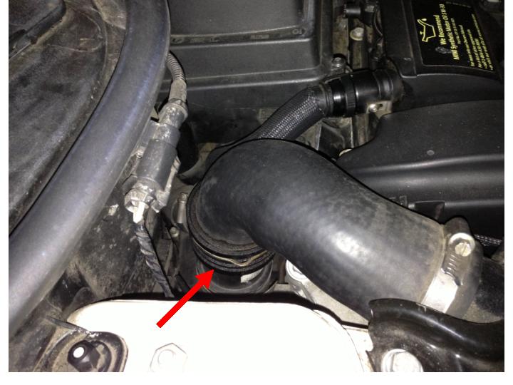

I've searched and searched but need some help identifying this hose with an oil leak. Thanks.

That's the 'cold-side' boost tube, which is apart of the intake system.
That oil seepage is typically from the oil vapor pulled in from the Positive Crankcase Ventilation (PCV) system.
Simply remove, clean and reassemble.
While removed, check to see how much oil film is inside... will that much seepage, I'll be curious how much oil is possibly collected in the intercooler.

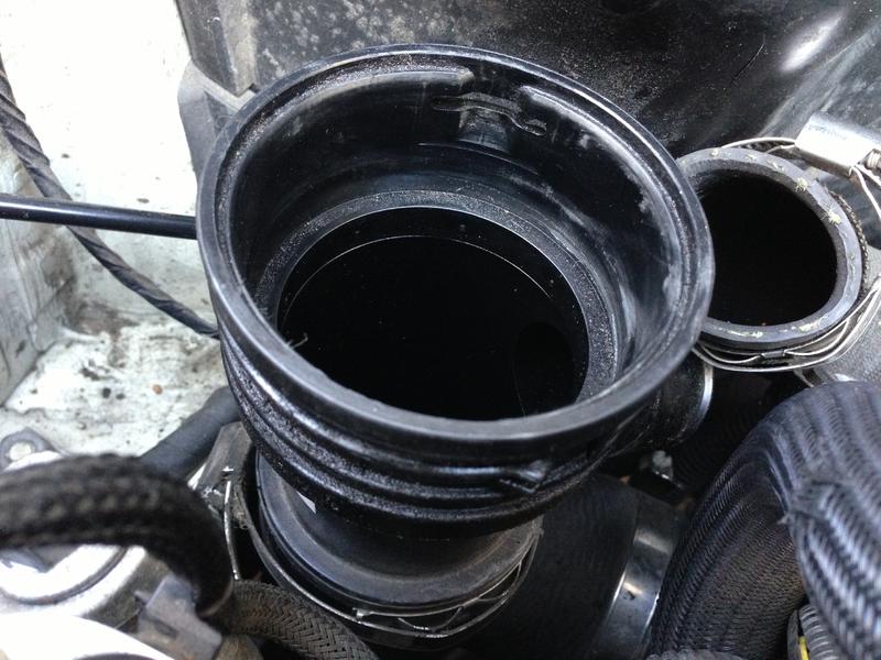

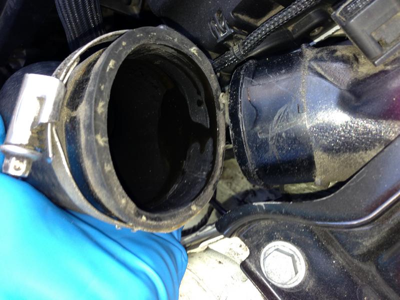

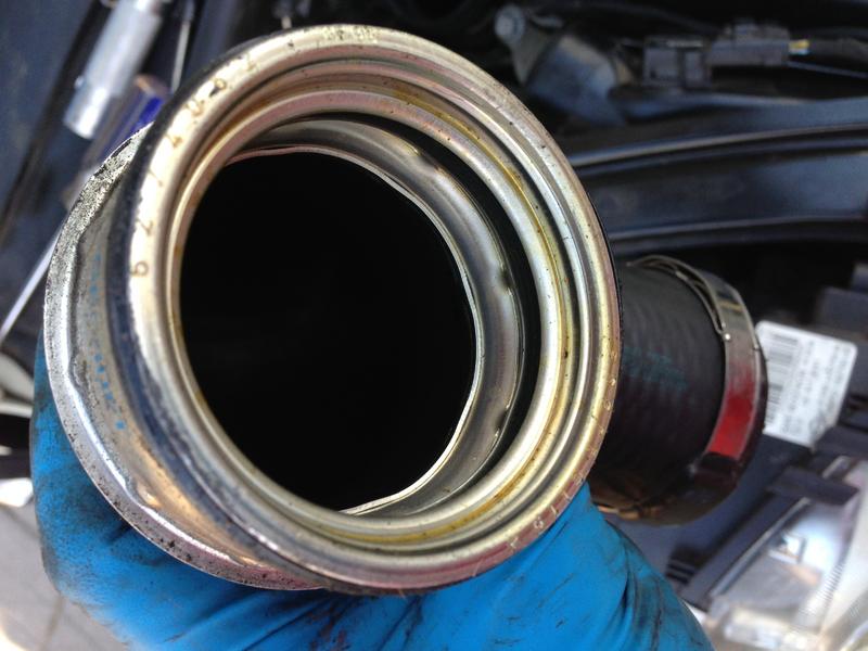

Thanks jcauseyfd, I looked all over and only see oil residue on the hose. I did take apart the cold side boost tube as bluefox280 suggested and found a broken rubber gasket/o-ring. As I took it apart, I did find oil on the top half as you can see in the pictures. The question is whether this is a lot?
That explains the seepage issue; when you make positive boost, the pressure is pushing the oil film out of the intake seals.
No, that's typically a normal "film" amount. A small collection pool can occur, but I don't see anything out of the ordinary.
Good news, with that replaced O-ring, you should have better holding boost pressure which will return some performance to the car.
