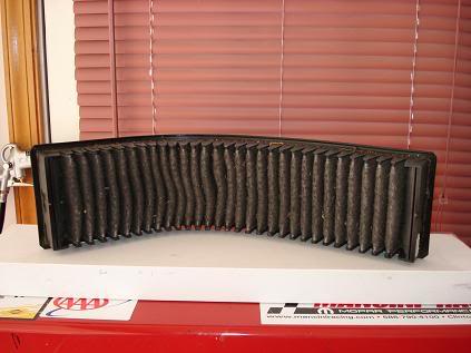

Can you use compressed air to clean the old filter and save $50 bucks, or should you just buy a new filter.
if the filter is doing its job, all you'll blow off is the surface crud but the micro-holes in the paper are still gonna be plugged. In a pinch I'll blow the big stuff off the filter in my shop vac but don't get anything near full performance until I actually buy a new paper element.

Wow - that's dirty.
I have a compressor and blow out a lot of filters but if mine looks like that I'll buy a new one.
