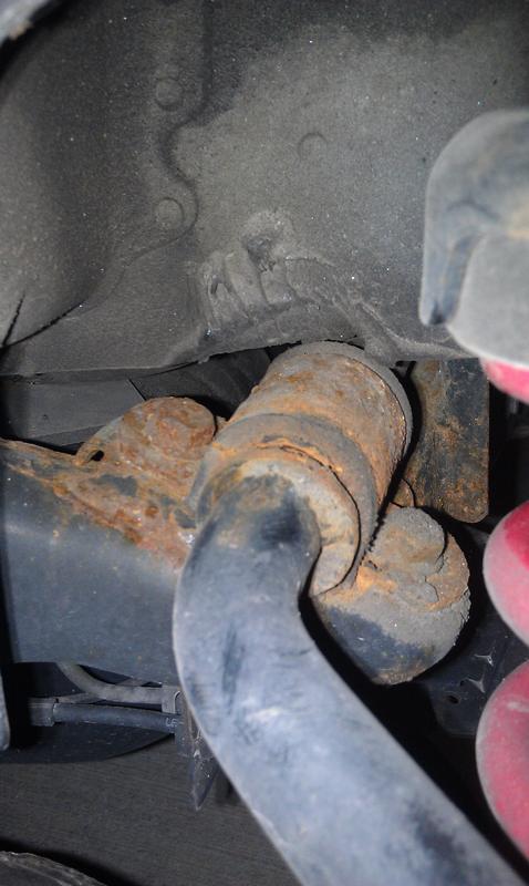

I checked the end links and sway mounts...everything is tight. Except the bushing looks suspicious...what do you guys think? Culprit?

I can't find the replacement bushing anywhere. It's like the internet has mis-labeled all rear bushings as front, and front bushings as rear.
What all "rear' bushings look like, which look nothing like the photo I have posted above.

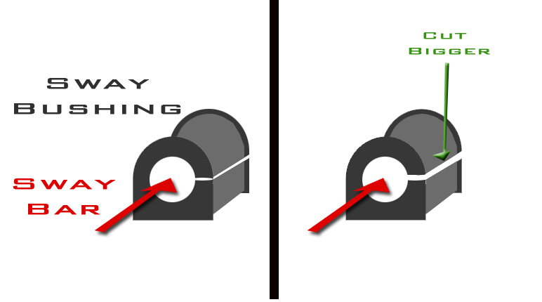

Found the problem: Posting a photo to help others that are searching for answers.
Summary: Rear Sway Bar bushing needs to be replaced. See below for a quick fix.
(You'll need to log in to see the photo)
The sway bushing has become compressed over time. You'll need to replace this, or, follow the photo. There is a slit in this bushing, which makes it easy to slide it on and off of the sway bar. You can cut this slit wider, which allows for the metal U-Bar to grasp the sway bar tighter, giving you no movement.
