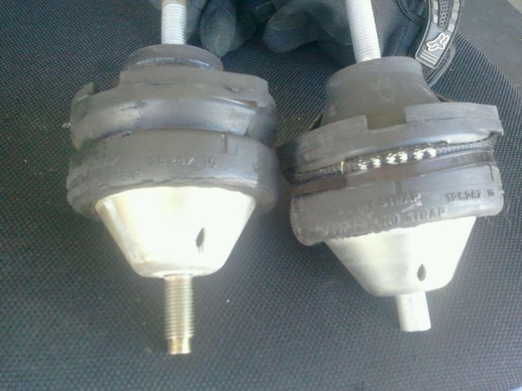

Also had to replace one of the motor mounts and found out I have a very early made mini.Name:  175984_504398559585256_302914391_o.jpg

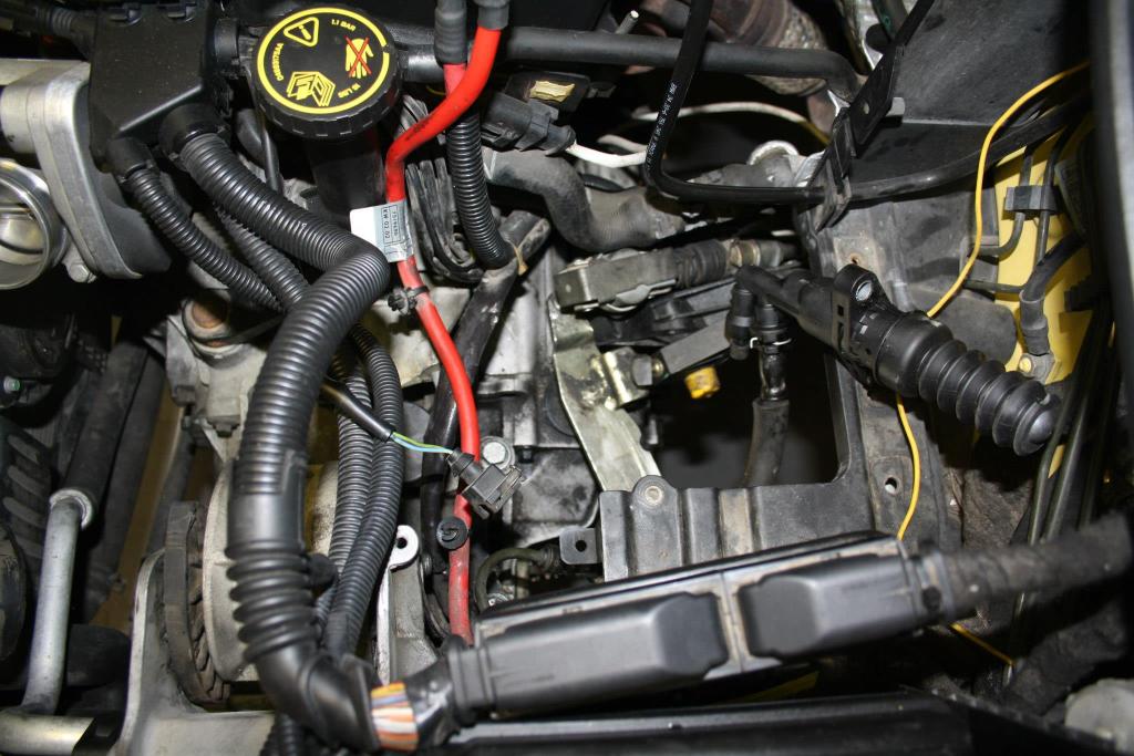

I am surprised that you got the tranny out without pulling the computer and Air filter box.

I did have to remove the air box, and the computer slides out of the battery box no problem.
