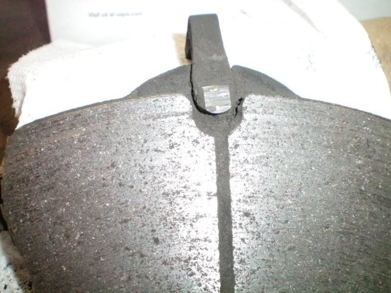

Hey all. Just got my 07 S Hardtop yesterday and I'm so excited but I'm having an issue. On the way home from where I bought it, I noticed a large drop in brake pedal response. After I'd pump it once or twice, it seemed to build up pressure again and give me a firm feel. Also when it did "grab", it pulled to the left a bit alarmingly. I haven't been able to recreate it and I know it had been sitting a couple months so that may have been the issue.
The more pressing matter though is the brake grinding. I thought it may have been the infamous "rear brakes rust and grind for a couple stops" issue (yes, I did a search!) but it is persistent. It looks like my pads have enough meat on them and my rotors aren't really grooved so I don't know where to look next. Insight?

It's definitely the front pads. The inside one on the pass side is metal on metal at this point. Replacing them tomorrow. We shall see!

those counters you see in the computer are 'count down' not 'miles since' . . . unless you already did some sort of math to get to your conclusion. I could easily see the computer saying 6k remaining on fronts when they are actually gone. What I believe happened on my 07 was the sensor tripped and the computer jumped to 6000 remaining. From my previous experience in the GEN1 world, I was surprised when I pulled my 07's pads, to find sensors front and rear triggered (but not down to metal on metal!) I thought I had miles to go b4 the sensor was hit.
look carefully and you can see the two wire stubs where the loop was broken...
