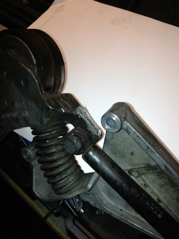

Old Sep 30, 2012 | 06:36 AM
Johnna's Avatar
Johnna
Joined: Jun 2002
Posts: 965
From: Loveland, CO
Originally Posted by Johnna
I just read a different post that could explain the failure of a fairly new harmonic balancer. Evidently, when a belt breaks, the belt tensioner slams into the harmonic balancer and wrecks it. The installation of a tensioner stop would have prevented that from happening.
It looks like I may be buying a new belt tensioner, a new harmonic balancer and a tensioner stop. Dang!
You can see grooves where the belt tensioner was rubbing on the belt less crank pulley (harmonic balancer)
