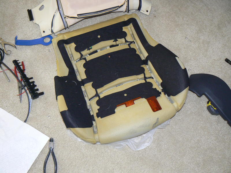

Also, when I sit in the seat (light on), all I have to do is push on the eraser button thing in the seat and the light goes off. WTF?? Is there just one pressure point? Its off to (my) right, just close enough to the back of the seat where you would never trigger it just by sitting down. Seems like a dumb place for a sensor. Thinking of going in the seat and moving it.

So it seems like I can feel about 6 of the little "eraser" sized buttons (on outside edges along the seam) which when pushed, get rid of the light. How exactly does the weight detection work? Seems like there are separate weight sensors (that actually work) to measure whether there's <80lbs. Those sensors (under the center of the cushion) seem very sensitive and work great. Are the sensors on the outside edge for >80lbs? What weight triggers the 1st stage (less powerful airbags)? The bags aren't just on/off, they have off - low speed - full speed, right?? I wonder if the low speed will at least go off when the light is on.

Seat sensor
FWIW, here is a picture of the seat sensor in my '06 with the seat cover removed. As you can see it is basically a flat sheet trying to conform to a non-flat cushion - which is why you get little bits poking up. I used some double-sided carpet tape to stick it down. The whole thing is a flexible printed circuit so I would imagine there is lot's of potential for breaks in the circuitry. I think it is a crock that they won't sell the sensor element separately - it would be a relatively easy job to replace it since the seat cover is secured with hog rings, not glued on like the seat backs.
