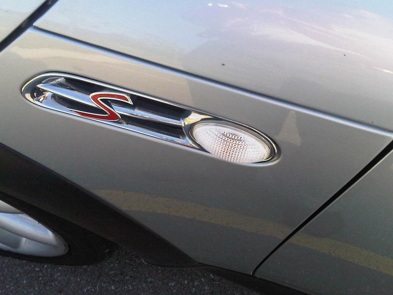

Hi everyone,
I tried searching on this, but all I could find was the info for R56s..
This is 2006 MCS.
Here is the pic - my side turn signal marker (not sure if that's what it's called - it is the white lens inside the side scuttle that houses the bulb) fell off and is now hanging by the wires.
How do I replace it? I ordered the part from the dealer, but I'm not sure if I have to remove the entire "S" scuttle or I can just pop the white lens back in?
This thing is so fragile, I'm afraid to break it - not cheap these things :(
Thanks in advance.

The scuttle does not need to be removed. When you get the new one you will see 2 clips on it. Once you install the bubl, you will put on one side and press it in and you wil here it click. Thats it.
