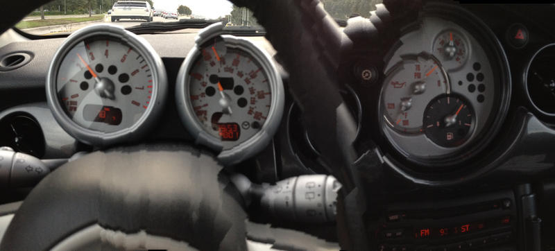

Also attached is a pic, Panorama View (blurred due to bumps) of my Dash. My speed is just below 60mph, rpm @ almost 2.5k in 6th gear. You can see by the pic, my Oil Pressure is just below 35 psi. At 80mph I'm running about 38psi.

Here's the pic
Sorry, but here is the pic. Forgot to put in my previous post.

And 10-15psi when at idle is exactly what I'm seeing on my OEM Factory Pressure gauges. Look at the pic and my needle is just below the first tick mark on the Oil Pressure Gauge when at idle.
Anyone else have the factory gauge pack that can attest to this?
