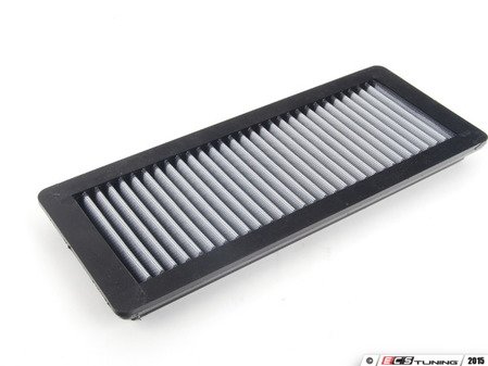

Amsoil Dry Filter is one of the few that does not need oil. I don't think it will work with a DDM CAI.
Put your stock CAI back on...poof, no more red MAF.
If you want a CAI that works without the hassle, JCW Stage 1 with the Amsoil dry filter.

The only issue I would have with putting the stock box back on and performing this procedure is that I do not have the stock filter anymore, because I ripped it when I removed it from unistalling the stock system. I basically just need to purchase another drop-in filter, I guess I could just purchase one from outmotoring.com.
I have read that doing what you state clears and resets the ECU as well as any presets in the car, however, that is a small price to pay for a clean running machine. But how do you know about doing this, and why did you need to do this or have you not done this yourself? Has anybody really done this and no if it reset back to stock settings or if it screws up the ECU and Engine more than what it is now.
Or a local auto parts store chain.

1) They are correct about aftermarket air filter systems which use oil as a medium for trapping dirt and particles. However, over oiling is not necessarily the reason why. It has always been my estimation that ANY oiled filter in a MINI ( 2009 - up ) using aftermarket oiled filters will eventually need a new MAF Sensor.
The reason is that in most other manufacturer of cars their MAF wire heats up after every engine shut down to 2,000 degrees for few seconds to burn off any impurities which may have attached itself to the wire....MINI's MAF does not do this.
If you have an "aftersales" JCW airbox system ( which takes the round cone style, same filter used in the JCW R53's ) you can replace that oiled type filter with this one from AMSOIL. They have blue high flow dry filters available. They're dry, reusable / cleanable. https://www.ecstuning.com/b-amsoil-p...r/eaau3570~ao/
If you have a factory JCW which came with the standard airbox filter system.....or if you have a stock filter system...this is a dry one also reusable and cleanable....
https://www.ecstuning.com/b-afe-part...ry-s/31-10174/
My second point is this....When it comes to engine managment systems like O2 sensors and such, most folks I know haven't had much luck with aftermarket replacements....eventually codes come up due to ohm resistence conflicts ( maybe due to inferior copper wiring or connectors ? ) and keeps receiving a CEL until a genuine MINI part is installed. That said, I would not be too hasty in giving up your old MAF sensor "as a core" for some other POS aftermarket brand....If it doesn't work and you end up needing to purchase an OEM part, MINI will not take the aftermarket part for their core. Every quarter BMW flags for core returns and that would be high on their list so you would be stuck paying the core fee....
