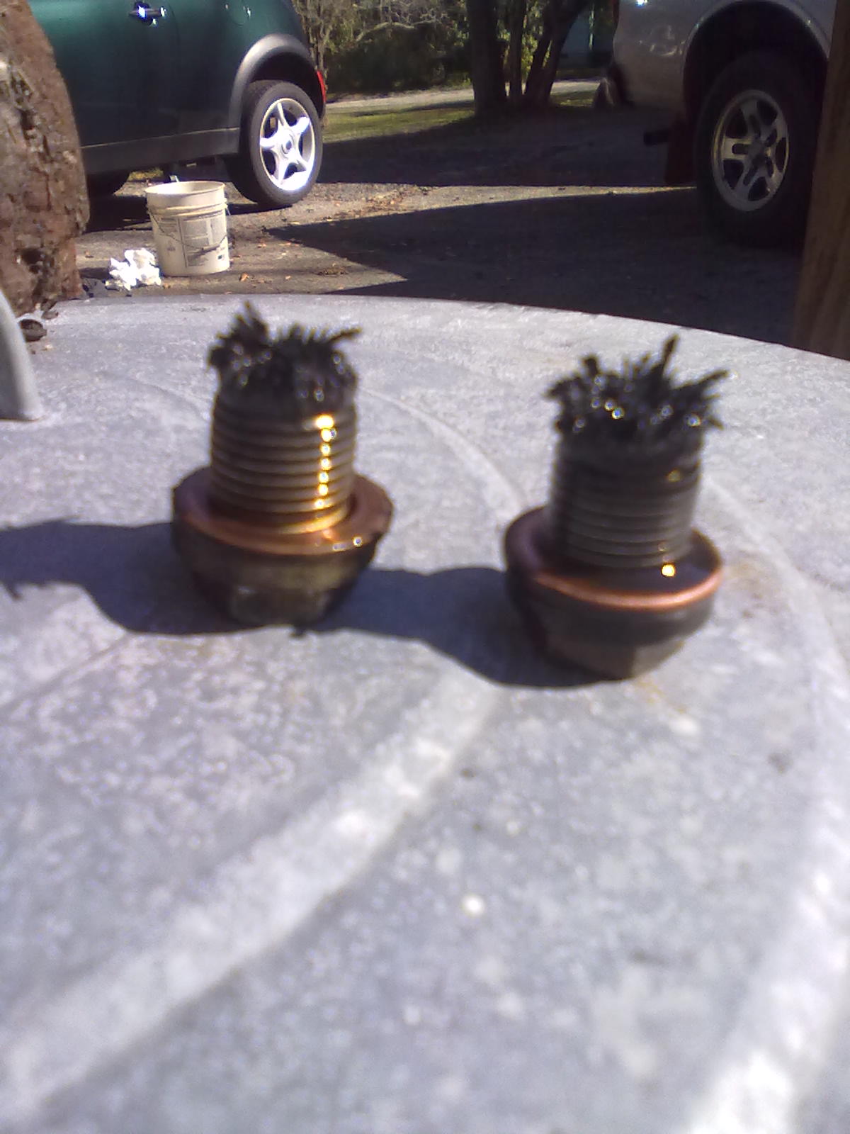

Here's the magnetic drain and fill plugs from my gearbox. Note the amount of metal filings they've collected. Glad I changed the oil out!
