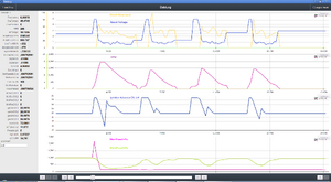

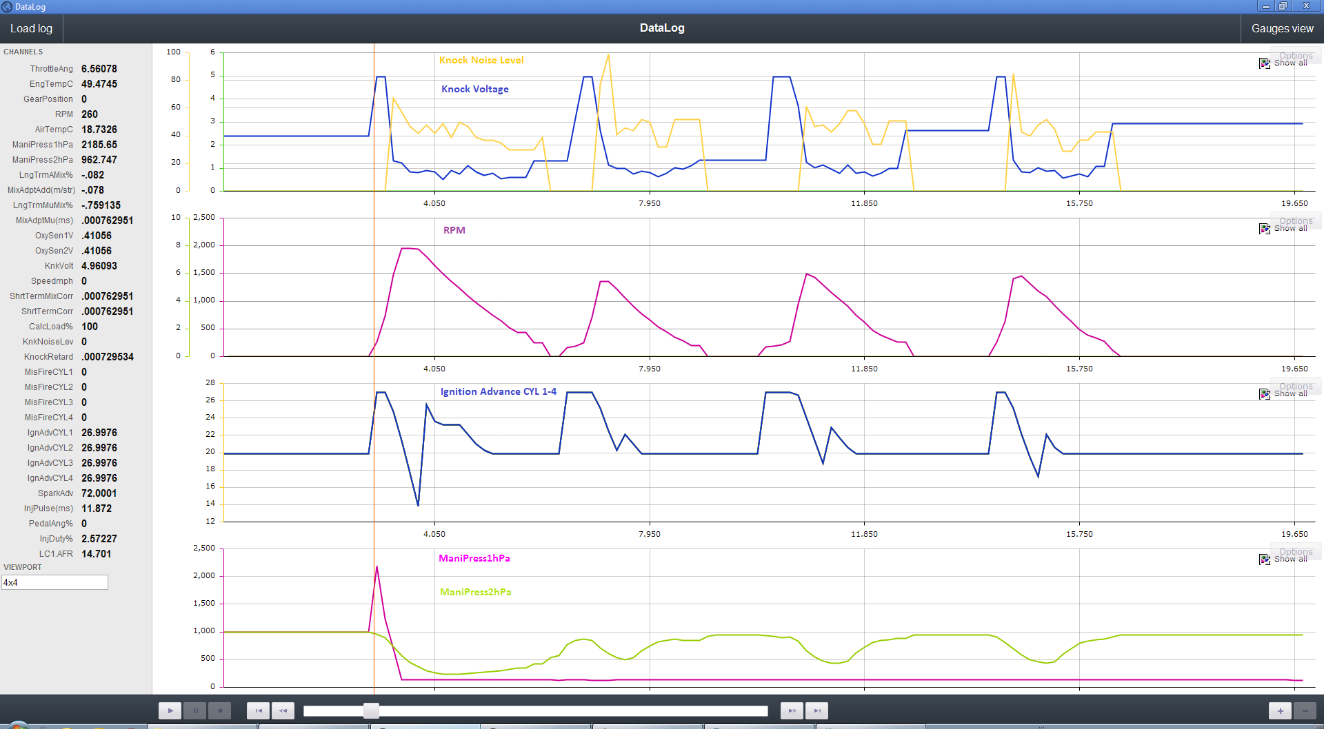

Here is the datalog from trying to start.
~5.0 in Knock Voltage is normal for the first 2-3 frames in cranking.
