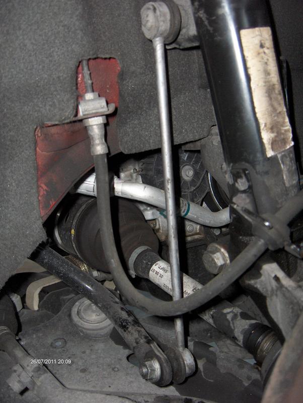

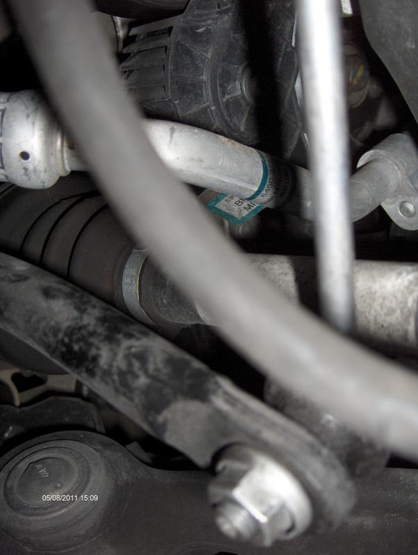

..last week, I put in the NM springs...and after reading this thread, made sure to look out for this.
Took some pics of the passenger side, 1st pic is before spring install, with tire off..and suspension hanging.
..2nd pic is after install, and car back on its wheels..just poked the camera around wheel and snapped pic...can see the AC line just about 1 inch above drive shaft.
It doesn't look to be close enough to be of concern even under hard compressions...right?
..be happy to hear any input from the suspension gurus.don't want any ac probs..here in Tx

got the car up on a lift today and took a peak. you can see here where the axle is rubbing the AC line. my quandary is that it doesn't look like there's a hole worn in yet, but i don't have any cold air. possibly this wear mark is making the wall thickness small enough for the refrigerant to leak out over time? or perhaps there's a hairline crack i couldn't feel with my finger.
it was mentioned in the KW instructions to "bend it up out of the way", but the line did not feel mailable. I could move it up maybe .5 - .75", but once i let go it just returned to the initial position. i did notice that in front of the rub, maybe 3", the line is sitting in this clip.
i didn't want to take it out of the clip for fear of it rubbing on the pulley you can see in the picture. would it be reasonable to make a small bracket to move the clip up a bit? or is it ok to take the AC line out of the clip and just let it sit above it?
for the record i'm on h&r street coilovers; the spring perches are sitting 15mm up from the bottom.

hardingsan, my line looks just like your's. I unclipped the line, moved it above the clip, and ziptied it about an inch higher. I'll have to check it again because the axle could cut right through the ziptie if they touch.
Also, if you can't find a leak, the standard procedure is to recharge the system with a dyed oil and look for the leak with a UV light. My A/C is running a lot warmer than it used to, so I'm going to have to do this as well.

Yup thats exactly what mine was like...I ordered a new line from penske parts for like $70 plus the rings. I'm going to take it to my mechanic today to get it done and move the line. He said maybe I hit a pothole hard enough to make the axle break the line.

tintman - in that pic of the line ziptied, ..is that showing clearance with your car resting normally on its suspension...or jacked up with suspension hanging?
..before you ziptied up higher, how close was it to the driveshaft while car resting normally on suspension?
...in my 2nd pic from earlier post...I've got about an inch of clearance...I should probably just move it up a bit just to be sure.

My pic is of the suspension hanging free. I'm not sure what the clearance was previously, but I raised the line about 1".
What's interesting is that not all R56's have that rubber cylinder on the axle. It looks like a vibration damper, but not sure.
