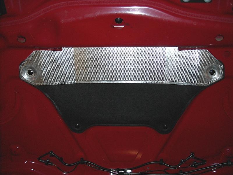

This one? Works perfectly fine, no scoop melting in my 18 months of ownership (and this has been on for less than a year).
You really don't want your scoop "absorbing" heat, not unless you want it really want it to sag. This won't "redirect" any heat back on the turbo, heat rises. Besides, heat is that turbos friend...but an enemy of your scoop.
No heat issues on my 2010, just so you know. I run this shield, a TitanNM heatshield above the turbo, and I have my scoop fully opened with a MiniFini stainless steel scoop grille.

Excellent info and pic! Looks just like the 1 from Minimania that I went ahead and ordered.

My 2010 MCS doesn't have the black piece under the heat shield.
What is that and is it standard equipment?

Nevermind - I found that this part is no longer included on 2010 MCS.
Is it possible they solved the hood scoop heat issue?
