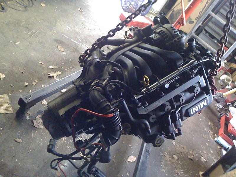

I haven't done mine. I'm actually going to do it on the bench, since I pulled my drivetrain for a trans swap. But I did note how challenging the job appears. Without having done it, or having my new Bentley book in hand (just ordered) I'd say your best bet might be going in through the driver side wheel well (might need to pull liner, but that's a 10 minute job) with a REALLY long 3/8" drive extension, or all your extensions connected. Harbor Freight is your friend for specialty tools you will only use for one job.
I currently have a bit of an easier time accessing my starter:
That is the ticket. If I remember even with the subframe down I still had 24in of 1/2in driver extension and an impact wrench to get that sucker off.
