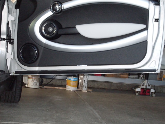

Picture added
Okay, got the door seals. Installation took a couple of minutes. Fit was perfect. I washed the car, and water on the seal was 100% better. Seems like the door closes with a more muted thunk as well. Makes the door look finished. I didn't add the 3m moulding tape, going to see how it goes. There are still 3 or 4 holes open on the bottom lip of the door, so water draining out of the door shouldn't be a problem. I think I will add a blast of compressed air to my car washing ritual just to be safe.
Do they just snap in place?

Yup, just snap into place. Snap on/snap off if you want. Fit is secure.

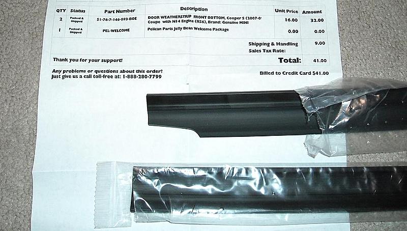

Got my seals a few days ago too, but haven't put them on yet. Been going through a hassle with PelicanParts over what appeared to me as a manufacturers defect of sorts...at least that's what Michael Ashcraft at PelicanParts is calling it.
But now here's the kicker Trex...I'm looking at your picture, and you have the same issue as me...see that little trimmed out cut at the end of the seal? (left side of your pic). I got both my seals delivered, but one of them is squared off on each end (what I presumed normal), and one has this funky cut in it. Since both seals are universal (meaning there's no left or right and p/n's are the same)then why this cut? If it's intended, why? and where is it to go? If I put the seal on the right door (like you), the cut is to the front of the door. If I put it on the left door, then it's to the back of the door. Only one of my two seals are like this, and no one knows why. My attached pic shows a close up of what I'm talking about.
So that's where my next headache started. I contacted PP and they apologized, thinking its a manufacturers defect on the part. They gave me an RMA to return the seal...but I gotta pay to ship it back. Ok....another $10 I'm thinking. They place a "new" order for my replacement seal, saying they weren't gonna charge me shipping for the new seal (damn right I'm thinking). I log on to find my new order for the replacement seal to be shipped out tomorrow, with $9.00 shipping added....I can go on and on, what a nightmare!
Anyways...do you or anyone else on here know why that cut is there? I thought I was an isolated case, but now I see you with the same cut.
This is perplexing....

Mine has the little trim out on both pieces, and the lame part is the cut out is on the same end. So in the picture (passenger side), the littled trimmed piece is towards the front of the car, on the driver's side (no picture of that), the trimmed piece is towards the back of the car.
I assumed they had sent me two for the same side of the car or something. If I had to guess, I would say the trimmed out end gives any water that does make it past the seal a place to drain out. I'll just trim up both ends of each to match and live with it. Nobody would ever notice it. Most people probably don't even notice the seal is missing to begin with.
TREX
p.s. It is an oem part, so you could wander down to the dealer and see what they have on the shelf.

Pretty goofy if you ask me, especially when you get two with this cut, and the same end...I got one uncut, and one cut...none of it makes any sense. Oh well.

Yeah 10zero, something isn't right. I received two of the exact same, so the part numbers were identical. did you happen to notice if your part numbers were the same? Pretty lame of Pelican Parts to make you pay for shipping in any direction if they think it is a manufacturer defect. Guess I'll cross them off the vendor list.
If I were you, whenever you get the replacement, I would throw it on and don't look back. They are worth having.

Part numbers are the same, so there's no left or right application. I've already put the "uncut" one on my drivers side, very impressed indeed. Just waiting for my "replacement" to arrive to put in on the passenger side. I think I've got the message as clear as I can to PP, to not send me another seal if it's cut like the first one. They've closed the last message ticket, so I'm hoping and assuming they're sending an uncut one. Worse comes to worse, I'll put the other one one where the cut will be to the front of the door like your pic.
