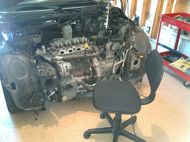

ive already got it torn apart most of the way. I dont think its a valve at this point... I pulled the rockers off and pressurized each cylinder. None of them had much of any air exiting the head on the intake or exhaust side. I have a real hard time believing its just a piece of carbon that became dislodged 1. Because my luck doesn't work that way, 2. it definitely sounds metallic, and C. if it was I would hear it when cranking. Its actually kinda nice to tear into the car this far so I can learn the engine better and not be in the dark every time it does something funky. It also had a coolant leak that I was having trouble tracking down and has always stumbled almost to stall just about every time it get started.
I guess the next thing I am going to do is pull the head off...

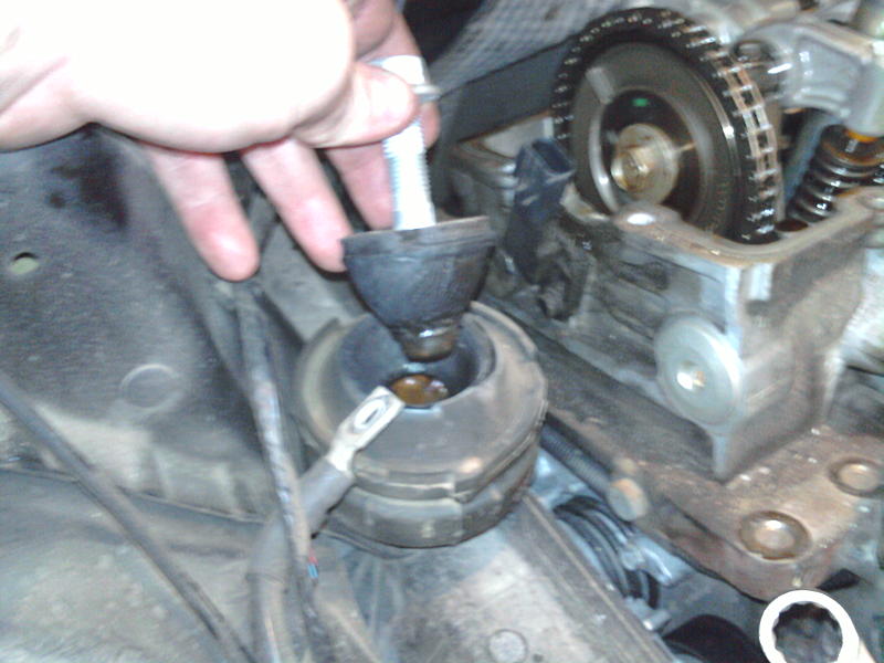

In the pic below you see the passenger side engine mount... is it supposed to be 2 pieces like that???
Are there any sensors or other things I should replace while I have it this far apart. Nothing seems bad but it does have 95k miles on it so I'd rather do those preventative maintenance things now while its easy.

That mount is toast.....pretty sure....I'd fix it....and see if the tap goes away before you dig deeper!! You might have been hearing the motor rocking, and bumping something....

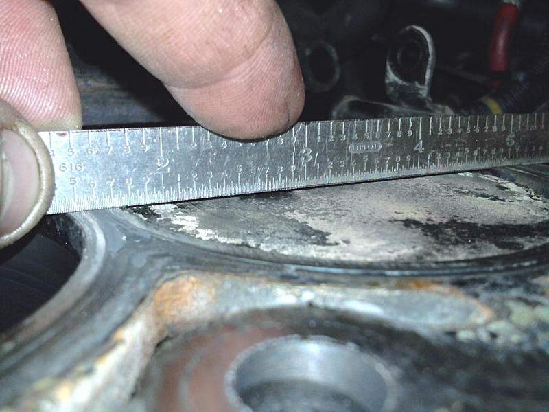

okay I think I found something wrong... pistons 2,3,4 all site maybe .050 below the deck at TDC but 1 sits about .250 below the deck!! I cant imagine what the rod would have to look like to cause that. Its not wobbly or anything but definitely not right. This would explain the 30psi drop in compression.
Also noticed a LOT of carbon build-up compared to what I am used to seeing. This is probably the reason seafoam usually does wonders for the mini.
first pic is piston 1 at tdc, second pic is #4 at tdc. I am noticing the carbon buildup in cylinder 1 (on the cylinder wall) and its way worse than the other cylinders... makes me think that maybe this rod has been bent for a while and I just made it worse.

I did the math and for the piston to site .2" lower, the rod would have the be bowed .6" at its peak so instead of the centerline of the rod looking like | it would look like ) with the max deflection being .6". This should look pretty cool, I'll pull the rod out tonight after work and post a pic...
Old Aug 23, 2010 | 11:39 AM
JumpingJackFlash's Avatar
JumpingJackFlash
Joined: Apr 2009
Posts: 1,361
From: Yorktown, VA
If the piston is coming up .250 short, it sounds like you have a spun bearing in the connecting rod journal at the crank. You might be able to spot this by pulling off the oil pan without pulling out the engine. A friend of mine replaced the oil pan gasket on my old '02 MCS without pulling the engine out, so it is possible.

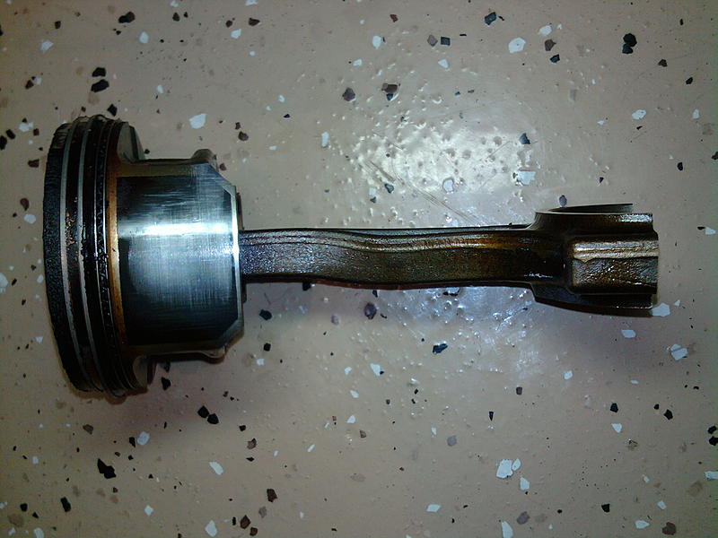

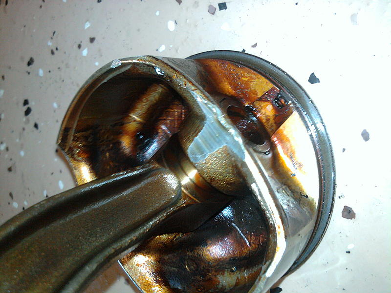

The good news is there is no damage to anything else really... The piston has some material removed but it doesn't look like too much to warrant replacing it. I'll measure it out to be sure but I think its fine. The crank I can't see any damage at all, cylinder wall is the same story. There was metal flake in the oil pan but none anywhere else.
Just sitting here thinking about it I am almost wondering if that cylinder wasn't dead or weak, thus allowing the seafoam to pool up until it hydrolocked it.
EDIT, just called MINI World in CA: 8729 Bradley Ave. Sun Valley, CA 91352 (818) 768-4800. He said they have the connecting rods with piston attached (since its a pressed pin) for $60!!! That sounds like a winner to me! Have to wait to order it until tomorrow.
Attached Thumbnails Tapping after Seafoam-2010-08-23-17.46.44.jpg   Tapping after Seafoam-2010-08-23-17.47.37.jpg   Tapping after Seafoam-2010-08-23-17.50.46.jpg

So was the tapping the sound of the piston skirt hitting one of the crankshaft counterweights? (I'm assuming that's what wore away the bottom of the skirt?) Considering the amount of material removed, I'm surprised the noise wasn't louder.
Glad to hear you found an inexpensive replacement that also saves you the decision of whether or not to re-use the stock piston!
Old Aug 23, 2010 | 07:52 PM
animuL's Avatar
animuL
Joined: Dec 2008
Posts: 36
Yes, the crank was contacting the bottom of the piston causing the tapping sound.
Oh and for the record, I ran a whole can of SeaFoam thru this engine and look at the pics, its still caked with carbon. SeaFail lol.
