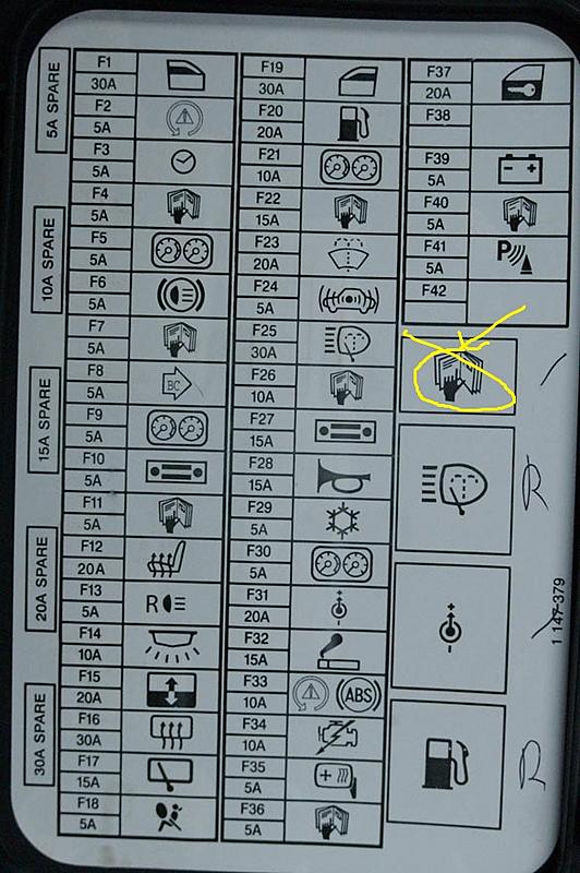

what fuse is this?
included is an attachment which points to the fuse.
is this a spare or what? i checked and i cant find this fuse. there are 3 light green ones under it but that fuse is missing!
what specification is this? part number? im going to order one if its important.
are they the black ones under the bonnet?

ok, apparently its the alarm relay, and i do not have car alarm. btw, i found out that the built in horn relay is bad, (clicking sound when you press the horn) and now i suspect that another relay near it is blown such as the power steering fan. the fuse box is 200 dollars, is an electrician needed to install it? or can one do it himself? is soldering or wire cutting required?

If you hear clicking, the relay is working properly. The "fuse" you are looking for in your diagram is a relay.
