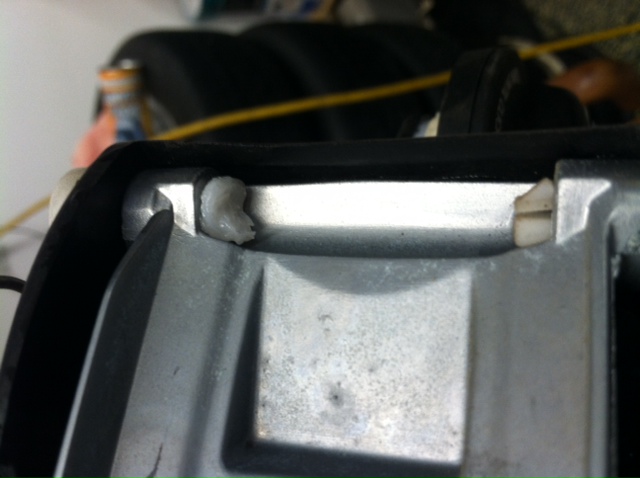

My fuel door was loose because the top hinge had worked its way out. This was due to the locking mechanism breaking off the inner end of the hinge pin. I inserted the broken hinge and put a spot of plastic on it with a plastic welder to keep if from working free again. You can see in the attached picture what the hinge should look like. You can see the split end of the hinge with locking mechanism on the bottom vs. the repaired hinge top.
