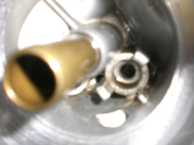

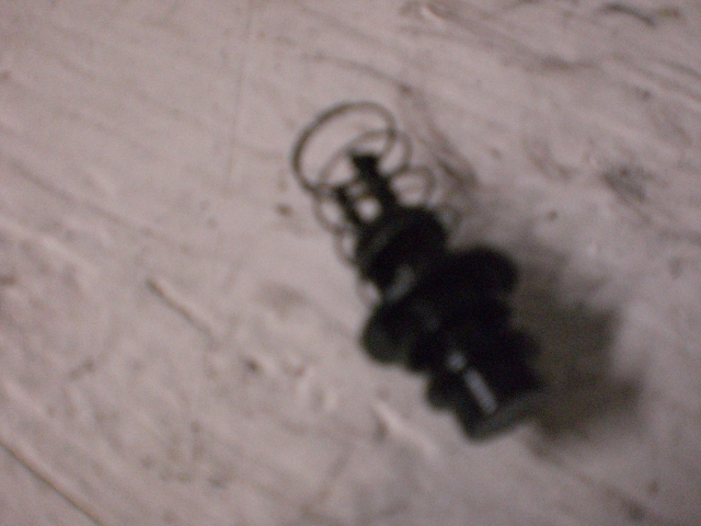

Does anyone know the name of this part?
I had to pull the oil filter housing to replace gaskets and this part was broken off. Its a spring loaded plastic piece that sits inside the oil filter area. Does anyone know the name of it and what it does? Thanx

No, it sits within #1

That's the oil bypass. You'll need a new filter housing if you want to replace it, which you need to do.

It actually looks like the oil filter will be holding this in place. So I may be alright.

check this out http://www.youtube.com/watch?v=djWm0gLqXAY
Old Apr 6, 2010 | 08:33 PM
tiny s's Avatar
tiny s
Joined: Apr 2010
Posts: 73
Yeah, thats it, the release valve.
